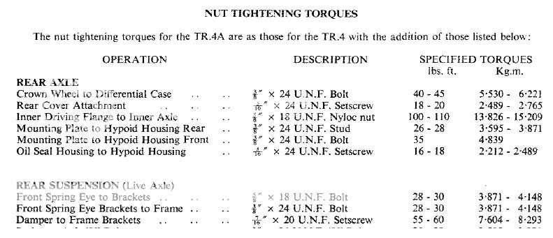

This is from a PDF, but matches my copy of the TR4 workshop manual 2nd edition (with TR4A supplement) in the blue binder

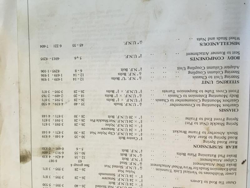

But, that's the TR4 section (same thing I wrongly copied above). On the next page is the TR4A supplement, which shows
Untitled_1.jpg~original
>scratches head<
You mean i've been torquing to the wrong values... DOH! (I would guess most are the same.)
