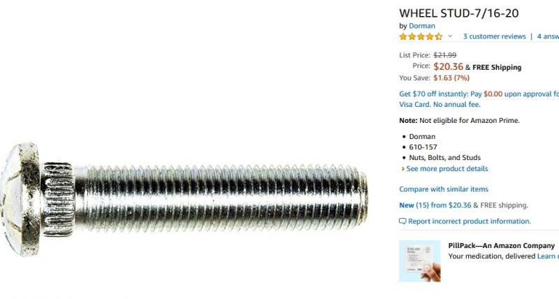

All the studs are 7/16-20. I believe your disc front studs are 2" long. Dorman sells these in a 10-pack:

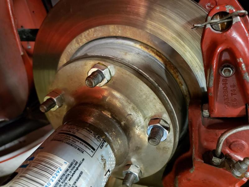

The fronts use regular (non-lug) nuts and washers. You could substitute all-steel locknuts.

Edit: I have a loaner rear hub with 2" studs; my own car has 2-1/4" studs. IMO 2" is the minimum length on the back. My previous post (deleted) showed 1-3/4" studs which on the back at least are too short.

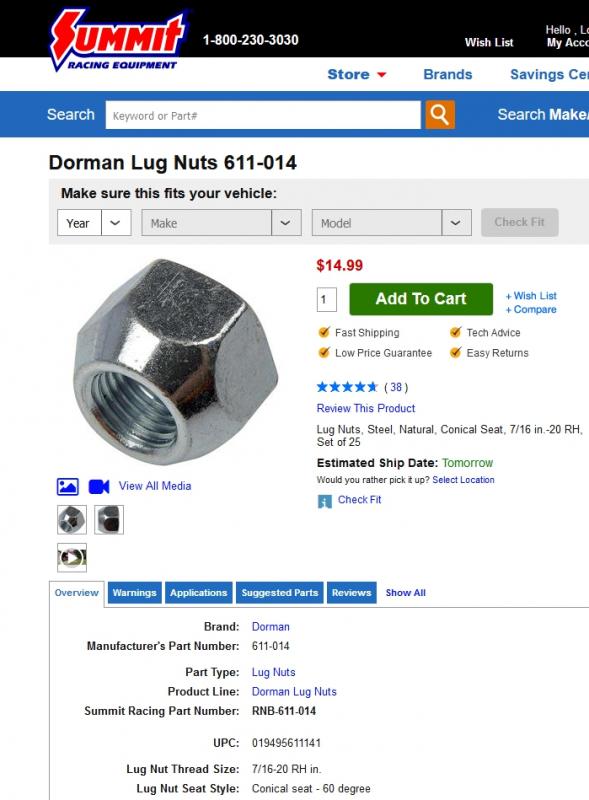

The bevel angle is the issue. I did a write up on this a longtime ago. The bevel on the commonly available new hubs from the usual suppliers is not the same as the originals. I found that the original-type lug nuts with the “built-in” lock washer did not grip the replacement hub and and did not fit properly. The dorman nuts did fit properly as the bevels matched up. I never had a problem with the nuts loosening once I switched to the dormans. I suppose if you still have the original hubs you would want to stick with the original-type nuts, but if you still have the original hubs the threads are probably suspect. Again, it is all in the matching bevel as Steve pointed out. Lin

Lin - going with the Dorman lug nuts and loctite. 25-price:
Steve, I have used the very same Dormans for 7-8 years with no loosening at all.
Lin
If Steve and Lin recommend the Doman nuts, only Randy Forbes's is missing to make this a indisputable decision..... Since Randy's under the weather, I'm going with them.
Well, just to restate, what is important and what makes one nut right and another one not, is that the conical seat of the hub needs to match up with the bevel of the nut. Somewhere along the line the hubs changed from original and at least with the ones I have the 60 degree bevel matches perfectly.
