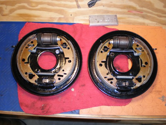

Here's a photo of mine (lemme know if I've got 'em right)....passenger side on the left, driver side on the right:
Yep, guess I should'a labeled the photo....passenger side in on the left, driver side on the right.

I'm now putting my brakes back on the rear end (out of car) & am trying to remember exactly what goes where....if I put it one way, the bleeder is behind the upright for the bumpstop...but if I put it another way, the park brake is in the wrong place...anybody got a photo of the rear of the brake assembly on the car - driver side?
Bleeder down I beleive.
