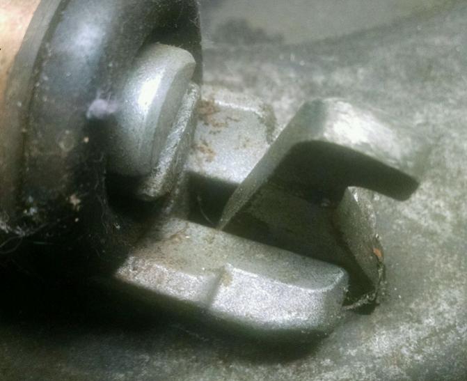

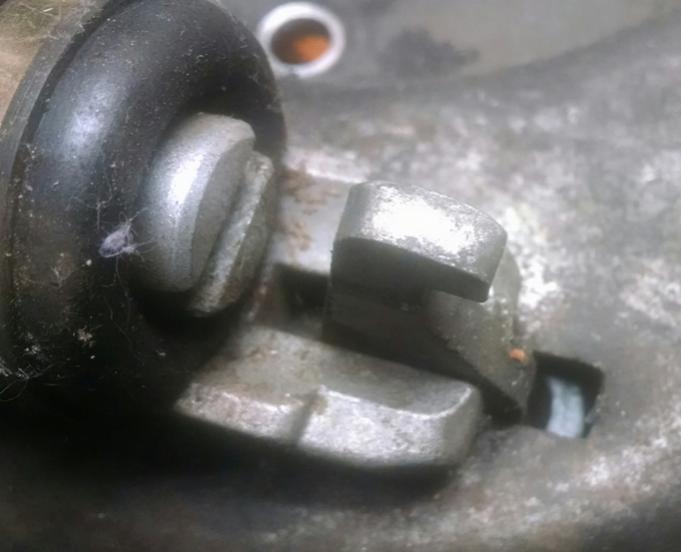

Travel is about 3/16" - probably centers once then doesn't move after that:
