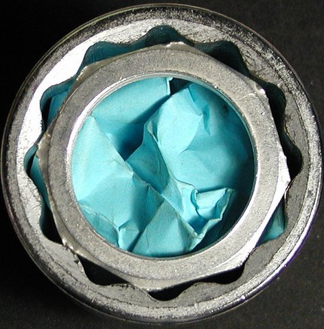

Unfortunately the Sears and other 12 point sockets will not work well. Sears and Snap-on do not carry an 8 point socket.
If the nut is torqued correctly you will have great difficulty getting the nut off with a Sears or other 12 point socket. You need the correct 8 sided tool. The picture below shows the fit with a Sears 12 Point 2 3/16” socket.

Thanks for the info Duane.

It doesn't look like that one will fit. It's designed for 1 15/16, not 2-3/16 or 2-13/64 as noted above.
