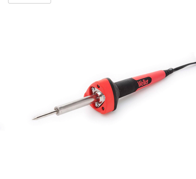

I use a 25 watt soldering iron like the one below. It’s certainly adequate for most jobs. Amazon has them for $13.
