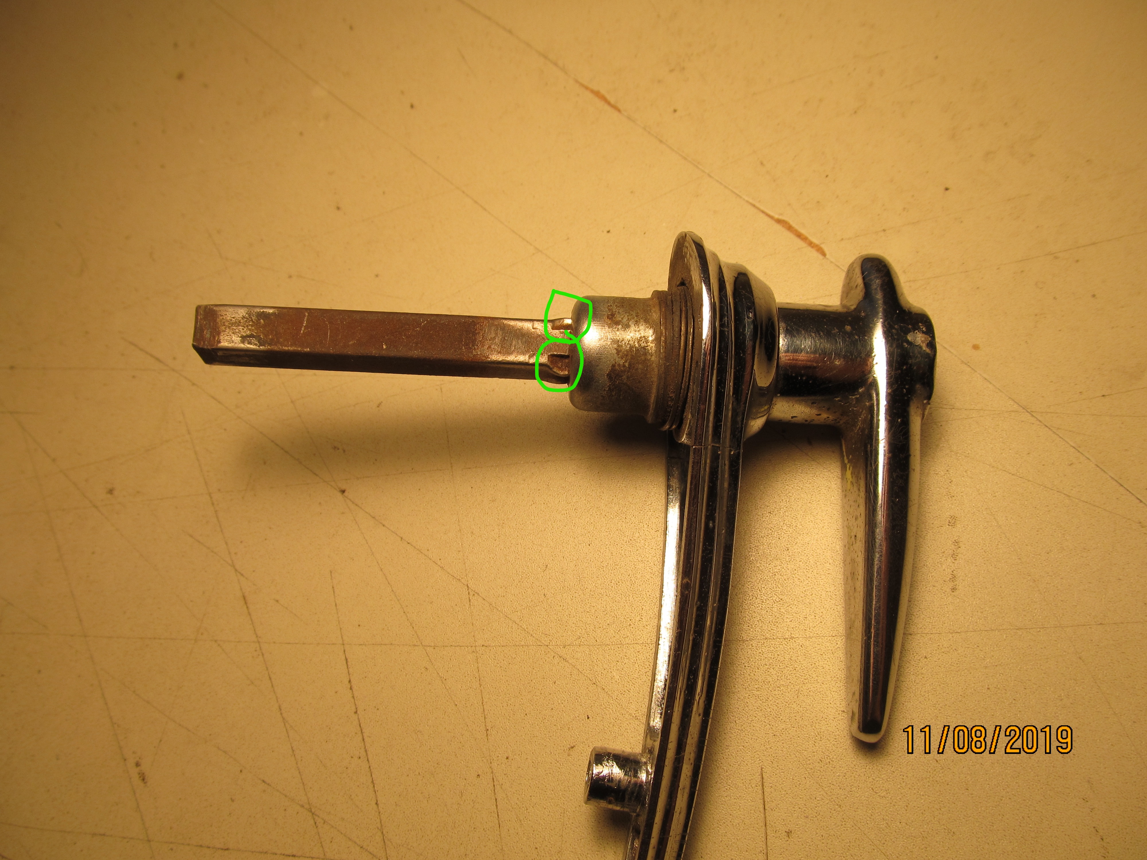

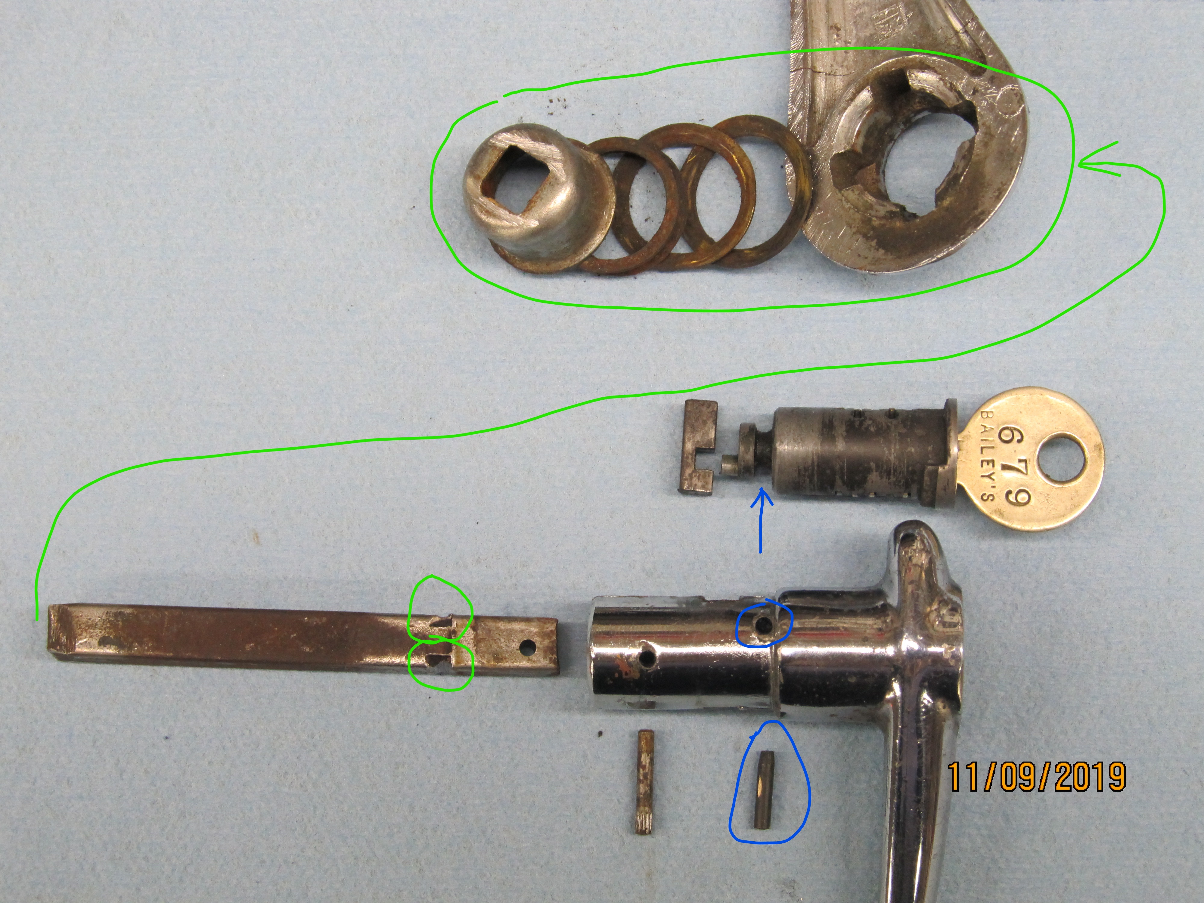

This might help. See the attached pictures of an assembled and exploded boot latch. You have to file away the 'pinches' circled in green and then the escutcheon and spring washers slide off of the lock shaft. Remove the pin circled in blue and the lock barrel can be removed. For reassembly, rather than try to re-pinch the square shaft, I pressed the cover on to compress the spring washers as it originally was and simply drilled a small hole in the square shaft and inserted a short roll pin.
Perfect! Thank you red57!
