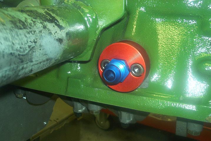

Here's a look at the oil exit fitting.

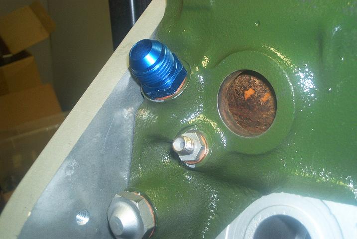

And here's a look at the WC intake oil block.
