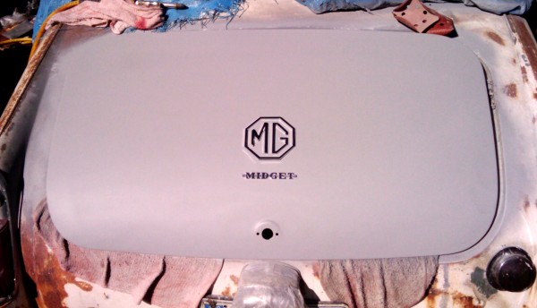

Maybe it's just the beaten out by hand look, they are not perfect like the newer panels. Maybe that's just age, I'm not sure. I am sure I really like my new trunk lid and when set side by side with the brown one with the pressed aluminum emblem I'd choose the MK1 lid every time. Heck it was way nicer than the brown one when it was just sitting in primer.
I have a picture of that:
