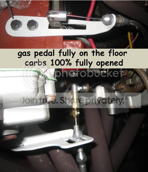

The linkage that came with the car was sloppy and sluggish.
There was always a slight hesitation before the carbs
responded to me pushing down on the gas pedal. Also, the
control arm was badly adjusted and topped out at around
4000 rpms with gas pedal on floor.
The Ratco cable linkage was an easy install. (once the
stupid kid on the block figured out the DPO's control arm
was installed improperly!) Paul's photos were a big help.
I'll author a "How To" for twin carbs in a bit.
The Ratco linkage response is instant and precise. The
movement is smooth with no hesitation, slop or
sluggishness. The gas pedal sits a bit higher off the
floor than it did before.

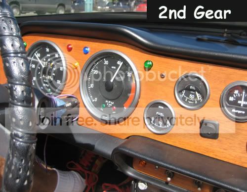

I admit to not having the stones to drive the car to
redline. I got it to about 4600 rpms in 3rd and was going
well over 70 mph. I was scared I'd blow up the engine. I
had some pedal left for sure and the tach was still easily
climbing. I have no doubts redline was easily within reach.
Left some rubber in the road a coupla times shifting into
2nd gear. The instant response will take some getting used
to !!
