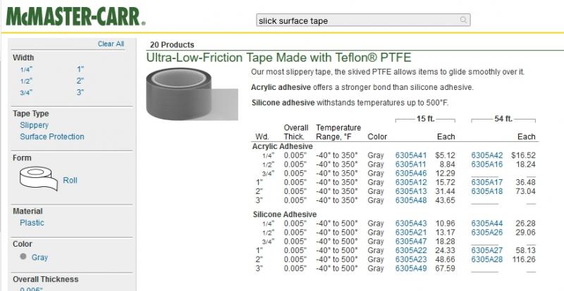

Because my original zinc interleaves shifted out from between the leaves, decided to replace them with tape.
Damping via friction between the leaves went out with Hartford shocks. See coil springs and torsion bars.
I used teflon adhesive tape between the leaves >15 years ago and it's still running fine with no squeaks.
If you decide to go with tape, what you want is 2" or 50mm ptfe or teflon adhesive tape.

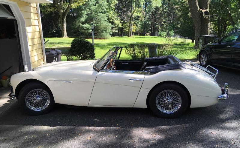

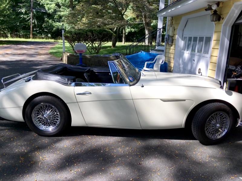

I am just back from measuring and the car is in fact low on the left both back AND front (as many of you predicted) by between 3/8" to 1/2" (+/- 1/16").
The actual ground clearance measurements from the concrete floor to the points of intersection of the transverse cross-members and the chassis rails--within the tolerances of a 4' spirit level and a steel tape--are:
Front left: 6-1/8" . Front right: 6-5/8"
Rear left: 7-0" Rear right: 7-3/8"
I don't know the source of the fore and aft rake but I really cannot notice it and in any case it does not bother me. The lean to the left does disturb me esthetically, and btw it is probably a bit greater when I am on board. However, given the tolerances of parts for our cars, etc. I wonder if it is worth doing anything or, in the words of Mick Mulvaney, should I just get over it?
Re: raising ride height
Michael,
If the levels were even, would you ever notice? From where I am coming, it is a matter of perception and what you like. I went through the effort because it both bothered me and was an interest and a challenge to correct. As I see it, pursuing improvements and corrections are integral parts of what has kept me interested for the past 55 years.
Keep in mind that the structure of the Healey (any model) is not as ridged as you may think and, as an example, wheel torque and driver-only operations seems to have worked on the left rear spring. Additionally, since the right spring is higher than the left, it could have an effect on the height of the front suspension. As you have seen, as the left rear sinks, the right front will be slightly relieved and get higher. Also, since there is some rigidity to the frame the left rear being lower will also contribute to the left front being lower as well.

Since these forces have developed during a long period of operation and frame/body-component settling, although my rear is now even, the front right is still slightly higher than the left, but it is not discernible by eye. Additionally, I lowered the front so the car is more even overall.
