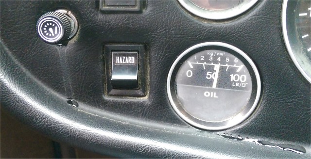

Here's what I got this afternoon.

Aww, you're dash light dimmer switch is crying. Have you not been paying it any attention lately?
Sorry, Rick, couldn't resist.
I know what a pain it is for me to keep my dimmer (rheostat/ whatever you want to call it) happy enough and willing to rotate. I can only imagine how temperamental it would be if it experienced wet and dry cycles. Not to mention that wet and dry cycles on electrical components are the things that perpetuate the legacy of Lucas lighting, King of Darkness.
Based solely on that picture, my money's on Joe Reed's suggestion above.
Also, check the joint at the top of the windshield frame where the stanchions meet the top of the frame.
