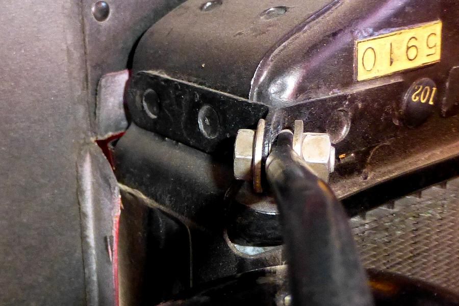

On the subject of radiator shrouds... I was under the bonnet a few minutes ago and thought to take this pic of how I did the 'shroud origami' at the top corners of the radiator:
I do not know if this is correct, so file it under 'what worked'.
That looks the same as what I did. Actually seemed to go in quite easily, but I didn't spend a lot of time worrying about everything being just so. I just creased the flaps and slid it in place, figuring that small leaks wouldn't hurt anything and in time it would conform to the apron better. Should be good enough as long as it doesn't block the radiator opening.
