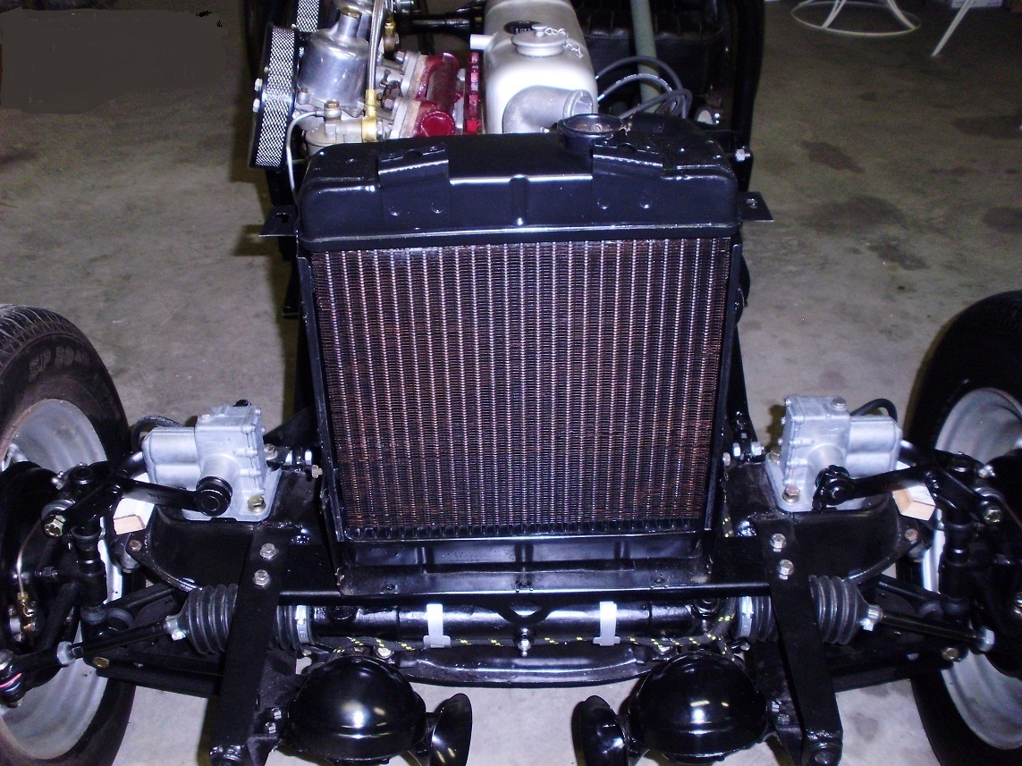

About $600 vs Moss @ $1669 on sale.Wizard cooling
If you want the best big Healey radiator available and you're not pinching pennies, I suggest the ProAlloy unit.
Austin Healey 3000 Radiator
Pro Alloy Water radiators are on average 50% lighter and 25% more efficient than the standard copper brass equivalent and are corrosion free and will out last even the best quality conventional radiator. This 60mm thick radiator core will keep your pride and joy cool, even on the hottest day...www.proalloystore.com
Original radiators can be repaired or recored. The problem is finding someone to do it.If you have a stock radiator, keep it. Get it cleaned/rebuilt/whatever. Add another core series.
My understanding is that the originals can be maintained and rebuilt, but that the aluminium ones can't.
We've improved the shroud and changed the fan(BJ7). We live in Calgary, Alberta (and use water wetter) so different constraints than living on the equator. Opinions are like noses: everyone has at least one. Make your choice, and don't revisit and be happy.
Fitment is perfect, but they too use metric nuts.Dougie, How's the fitment? Word has it the Wizards require some tweaking (and use metric nuts).
