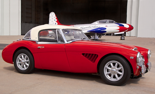

I do suspect the r&p is superior to the old stuff. That said, when I rebuilt mine I put in a DWM 5-axis cut steering shaft, all new stuff in box, and after getting the free play dialed in (took a few tries)... I have to say it's really very good... almost 0 free play, very responsive, etc.... I couldn't ask for much more. I should note I have adjustable front suspension (Varley's adjustable shock mounts from Australia) set at 1/2 deg. negative camber and Udo Putzke's Bilstein kit, Mini-lite wheels, etc.... so, I suspect (or hope) these items contribute to the overall steering quality.
