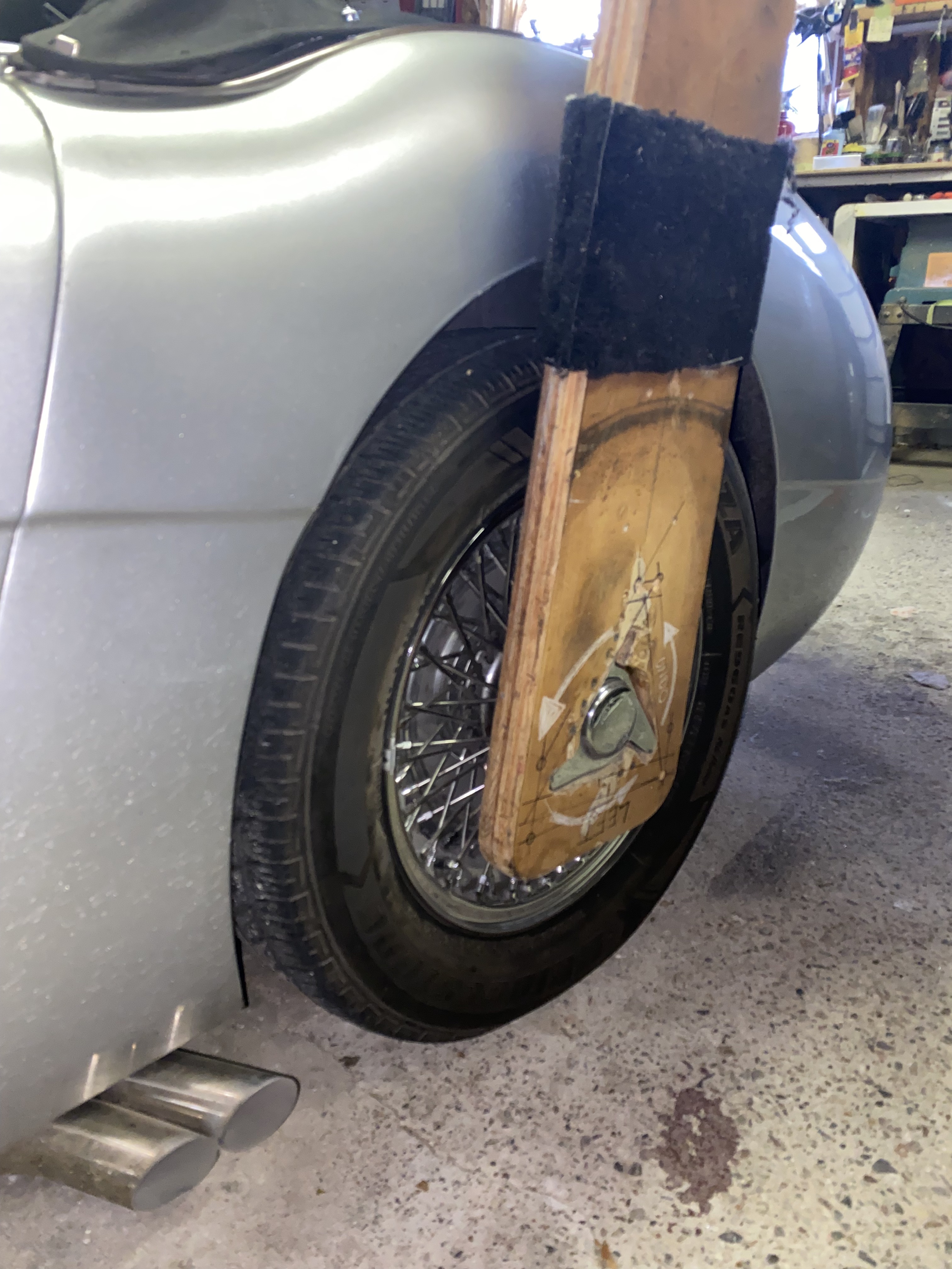

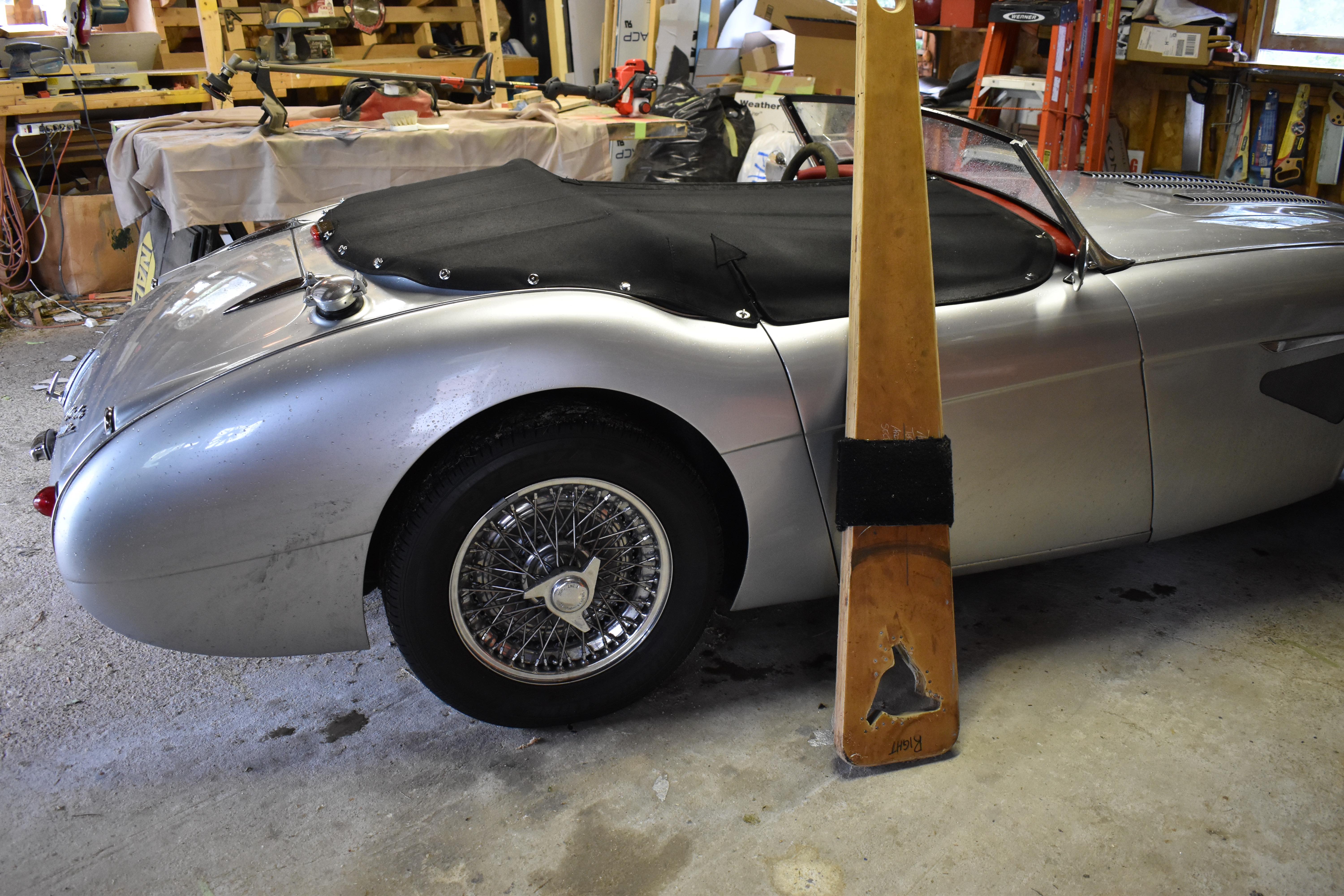

I just use a standard Craftsman Floor Jack but if you'd like something a little more unique to remove the Knock Off's you might consider this.
I never liked beating the crap outta the Knock Off's when removing a wheel and I've seen the various offerings to serve this purpose but you still have to use a hammer, my idea eliminates the hammer.
Obviously this is only good in the shop but you get the idea.
The carpet prevents scratching the fenders.
