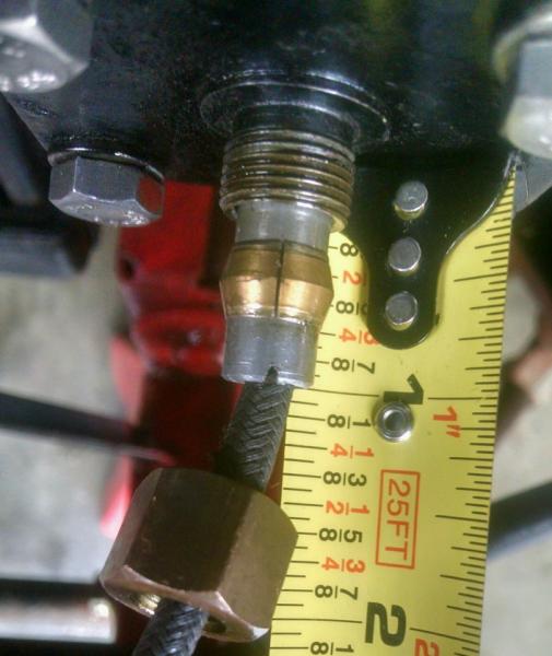

Here is the projection with the steering wheel in the forwardmost position and the trafficator head fully seated:
It's a good thing you are using corn head grease with that new split olive.
I dunno, it might be the original Healey olive. Never leaked previous penrite either. It may tighten up when the nut's tightened in place.
PS - how do we know they don't come that way?
Mine, what I think was original wasn’t that way and the one I have now, bought 20 years ago isn’t. I heard from a guy in Texas that the split ones leak.
Here's why I think the split is real and doesn't leak - when you tighten the nut, it compresses the split together and clamps it to the stator tube - ergo no leak.
