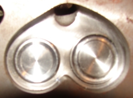

Questions-12G295 head.
The numbers are cast into the top of the head under the rockers.
Like this:
Ray

Mike, the 206 head I have handy has the numbers in the same spot as Rays pictured 295. The 202 has them between #1 & #2 intake valves.
The 206 also has a date code, 1/63, cast directly above the numbers.
Jeff
I think the orginal Bugeye head number is between 3 and 4 but I have not looked in a long time so don't hold me to that.
Well I had to go digging to see what I had back there and it looks like both engines have 12G1316 castings. What kind of head does that denote? One is a high compression engine and the other is low!
A 1316 head is not even referenced in Vizard.

The only two heads every made for the 1275 are the 12G940 (pre somog) and the 121316 (smog) thay both make good heads for porting, in fact the 12G1316 is preferrd by some porters. Long story short, don't look at the smog head 12G1316 as being a shortcoming, it's not.
Nice to know since I have at least two of them!! /bcforum/images/%%GRAEMLIN_URL%%/thumbsup.gif
