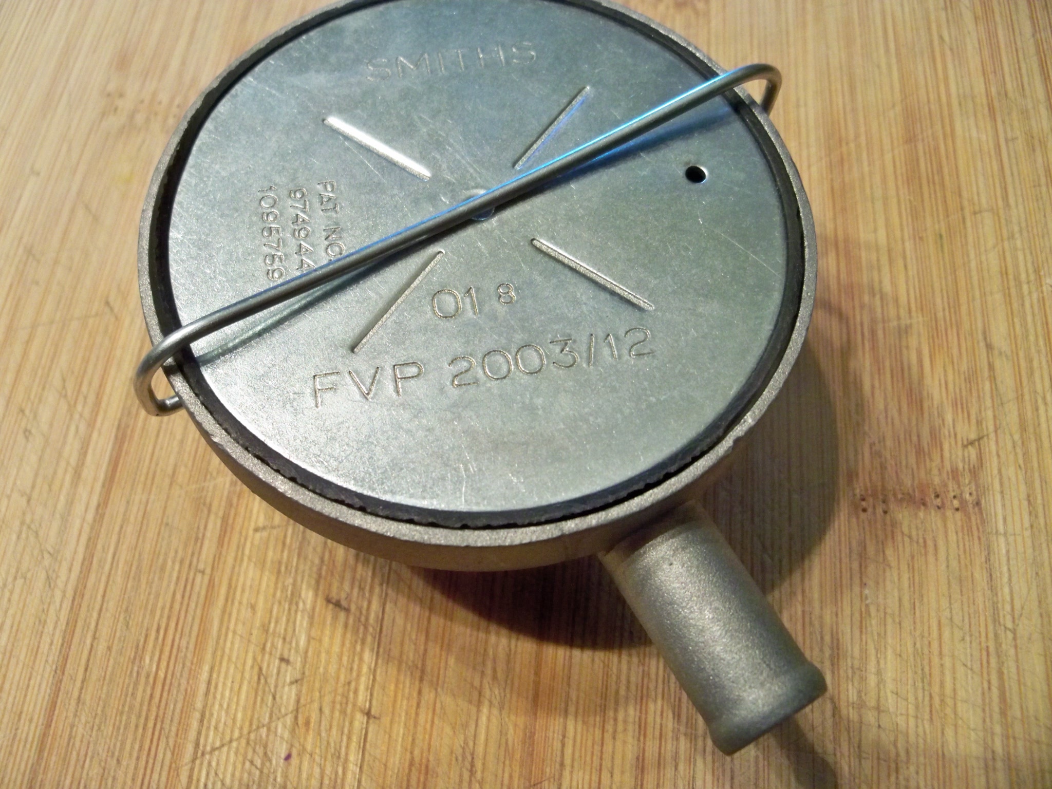

Yes, definitely a rubber or neoprene diaphragm in there. That's what creates the seal to allow "something" to happen. I just don't know what. I guess there's a connection between the diaphragm and that little hole on top--whatever. My mechanic says the amount of oil in the PCV tells him I'm getting too much blowby, and something's wrong. He suggests removing the PCV and adding a draft tube--or venting the valve cover with a tube curved from the valve cover down under the engine as others have suggested. To add a standard TR4 type draft tube I'd need to raise the engine to pop out that freeze plug. Not enough room to work down there, as there is only 4.5 inches to the side firewall.

This is the type of PCV valve that was on the TR250 and the 69 TR6 engines
The internal diaphragm is Moss part # 360-635
Then, as I said, a bad diaphragm will act as a vacuum leak, raising the idle speed. You will not be able to slow the idle, or correct the idle mixture. The purpose of the diaphragm is to limit the blowby to the intake at idle and low speeds. Without the diaphragm integrity, the valve will fully open, venting too much blowby into the intake and acting as a vacuum leak.
