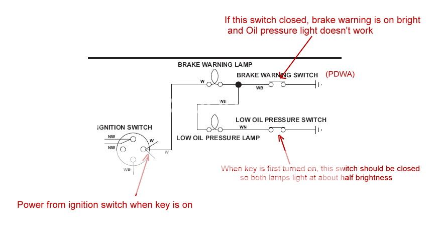

The PDWA (the whole assembly that carries that switch under the MC) should ground the wire to make the light come on, so connect a jumper from the wire to ground and turn the key on. If the light stays off, there is a wiring problem (or a bad bulb).
The PDWA should only actuate when there is a significant difference in pressure between front & rear; what are you doing to actuate it? Once actuated, it has to be manually moved back to center (which is a PITA).
But if you found a bunch of corrosion on it, most likely the switch doesn't work. IIRC it isn't really a switch anyway, just a spring-loaded plunger that contacts and completes the ground through the moving spool piece.

I connected wire to battery ground & turned on ignition. No dash light. I then put my 12V test light from the wire to battery positive. The test light lit brightly. No light on the dash. When I turned on the ignition, the test light dimmed from the positive terminal. Still no dash light. Any idea what all this means?

The oil pressure switch and lamp are effectively in parallel with the PDWA switch, so your test light may have seen a path to ground through the oil light and OP switch (which would be closed with the engine off). To verify that, you can try pulling the white/brown wire off of the oil pressure switch.
But I can't explain why the test light would dim if the PDWA bulb is burned out or not connected. Could it be hanging down behind the dash instead of in it's holder?

With proper circuitry that part sounds normal...With the ignition key in the ON/RUN position, the voltage to the BRAKE lamp gets cut in half to 6 volts.
The other 6 volts goes to the low Oil Pressure warning lamp.
Right. I was just thinking that, with the brake warning light burned out or disconnected, there would be no path through the oil light.
Having the oil light work normally must mean the brake bulb is in-circuit, or else someone has put a resistor in it's place.

The only "bulb test" function is for the brake warning lamp (which I believe was mandated by the same US law that required the lamp in the first place); which is why it's wired in with the oil pressure switch. All of the other indicator lamps should only indicate when their condition exists (eg turn signal indicators only when turn signals are actually lit).
Here's a drawing of the PDWA circuit, with some annotations
