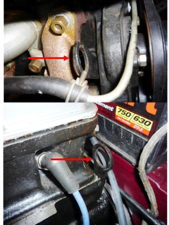

Well the time has arrived, I am planning on pulling the engine in my TR6 in the next few weekends and ship it off to be rebuilt. I am trying to figure the easiest way to pull the engine, I have a warehouse( same place I painted my car last fall this time) we have a fork lift that I plan on using to lift the engine out. I purchased a tilt mechanism from harbor freight. I will put the car on 4 jack stands for access. Only question I have so far is where do I bolt the tilting devise to the engine? I guess to make things easy I shall pull the passenger seat out, carpet, trans tunnel to un bolt the transmission. thats as far as I have thought about it.

Sounds like you're missing the lifting brackets. Mine bolted to the block just behind the water pump in front and on the drivers side in back.

Here are pics of the lifting brackets. One on the passenger side just behind the water pump, and one on the drivers side at rear of engine by the fire wall....

I was looking thru some pics on my computer and I think I spotted the one on the drivers side rear, but I cannot see from the pic if there is a front one, I will check it when I get home
if any one has a pic of one for the front, if mine is missing I will have to fab one up

well I just checked the engine and both lifting eyes are on the engine. I also plan on pulling everything out of the engine bay, radiator, shroud, front support brace, loosen the steering rack, maybe pull it too. Might as well take the seat out and pull the tunnel, transmission is comming out to I have to replace the oil seals in the transmission, I think they are source of my leak. Once going pics will be posted
