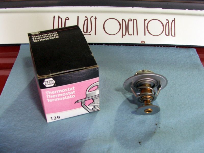

Make sure you have the correct thermostat...I have a NAPA part number at home that I'll post if you need it.

Here ya go! I've also got a part number for the air pump filter if you need it...BTW, it is NOT AT ALL similar to the MGB air pump filter.

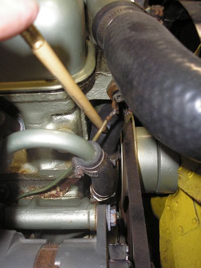

Thanks gents! I really appreciate it. One quick question for you, Rick. Since I've never opened her up before, I'm not terribly familiar with the C's engine. I'd love more information on the bypass hose. Thanks!

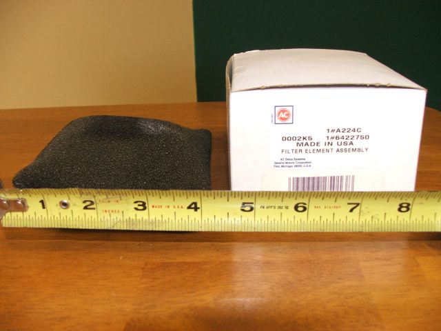

Here's the filter for the emissions control air pump. I sourced it at a Cadillac dealership (if you can find one these days).

The bypass hose is a small, 90* hose that runs from the water pump to a fitting on the front of the head. You'll see it as you begin to dismantle the top end.
It can be a bugger to get on...heating the hose in some hot water and using a little rubber-friendly grease (such as brake grease) will help in reassembly. (Don't forget to put the hose clamps on BEFORE you assemble....ask me why I give this hint!)
:nopity:
Bob Kirk has these hoses in stock (I believe) - or you could take the hose into a local parts house and match it up with/use a piece of a similar shape/size hose currently being used on American/Foreign cars. (I think Ford has one such hose that has enough there to make a couple of these hoses.)
It is wise to replace this hose with a fresh hose now, with disassembly, rather than later, on the side of the road.
:wall:
This picture shows a "side view" of the hose as taken from the right hand side of the engine bay...the pencil is pointing to the culprit.
