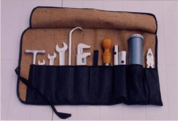

See the tool kit that came with my 1958 TR3A. The long tool (5th from the left) with the hook at the top end is for removing the hub caps from an early TR with steel wheels.

Wow, very nice tool kit! I've never seen an original one.
