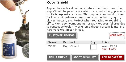

With respect to everyone's personal opinion and experience, another alternative is "Kopr-shield".
Its a conductive contact grease sold by Eastwood. Since it's conductive, you don't want to use it anyplace where two connectors might short out (i.e., when rebuilding a switch)
I recently had a TR6 customer who was having all sorts of electrical demons with a brand new wiring harness. After tracing 3 problems to connectors, we pulled all the connectors and greased 'em. No complaints since.
We are located in a humid, dirty urban environment though - bad for electrical connections.
Where kopr-shield is't practical, I use silicone grease in moderation. Seems to keep surface corrosion at bay, and keeps bullet connectors from getting "stuck".

Well Eschneider, you just rang my bell again. When in this world did you ever see a grease that was conductive, ain't no such animal around. What is being done is the marketing people need some type of a gimmick to sell their product. So the take a dielectric; "Grease", fill it with copper granules and lacking any real imagination call it conductive grease.Grease is not conductive and the copper granules are the components that perform the conductive function the grease just keeps them put. OTOH ,Silicone grease used as you stated IMOP is a better choice.----Keoke

you make it so easy to torment you. <laugh>
here is the stuff. And it appears you are, indeed correct (not surprising) - reading the description closely, it says "promotes conductivity"..... rather than being conductive.
