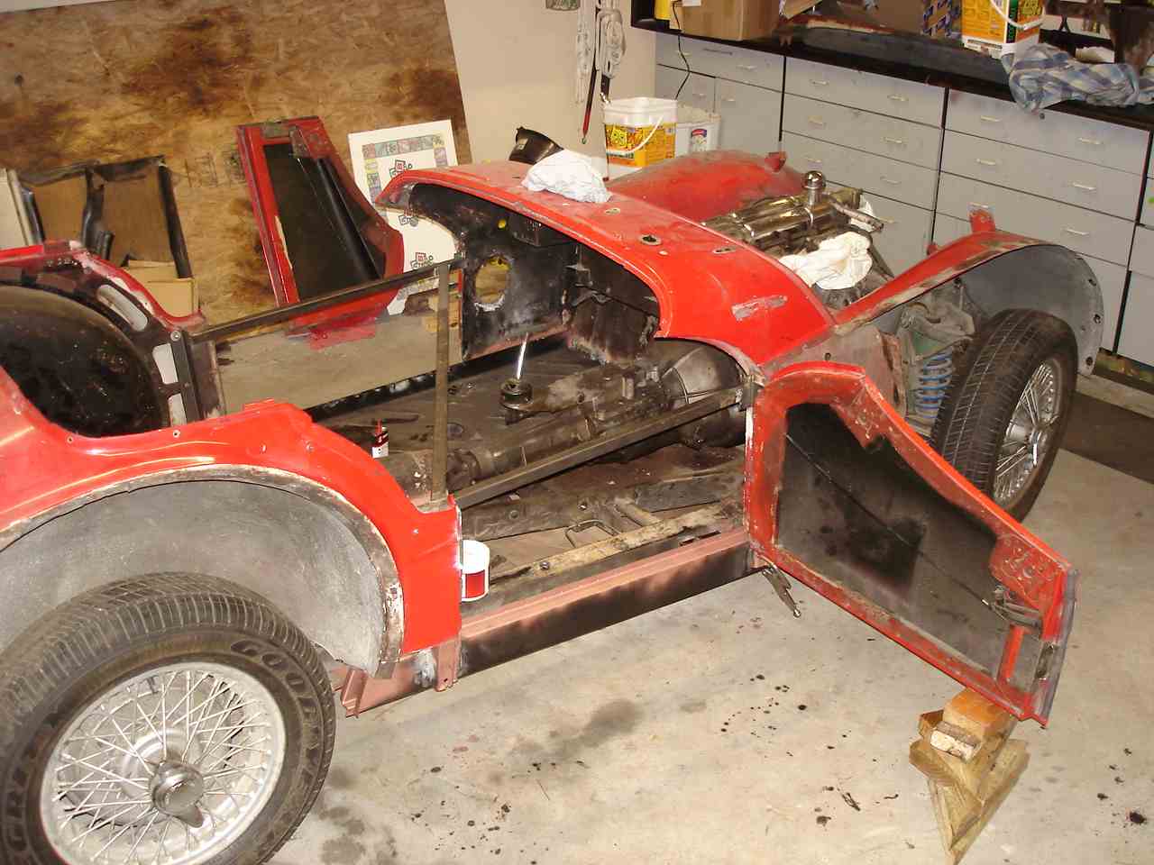

Now, as to the project update, I have attached a photo of my now partially attached PS inner sill. I gave up on trying to remove the carrier (see my other post if you know how) My TR time was cut short on Sunday prior to welding the A post. It still feels like progress though.
