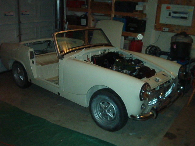

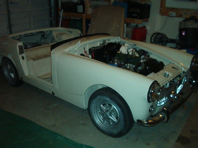

well, it's time for pics - Before and After. The windshield is in place but not quite levered down - I've decided to let it rest for to night - but, any ideas for that last 1/2 inch?

Tap gently on each post with a rubber hammer? Silicone spray on the post and sockets? Never had to do this.
Is the rubber keeping it from seating down?
Heavy friends?
