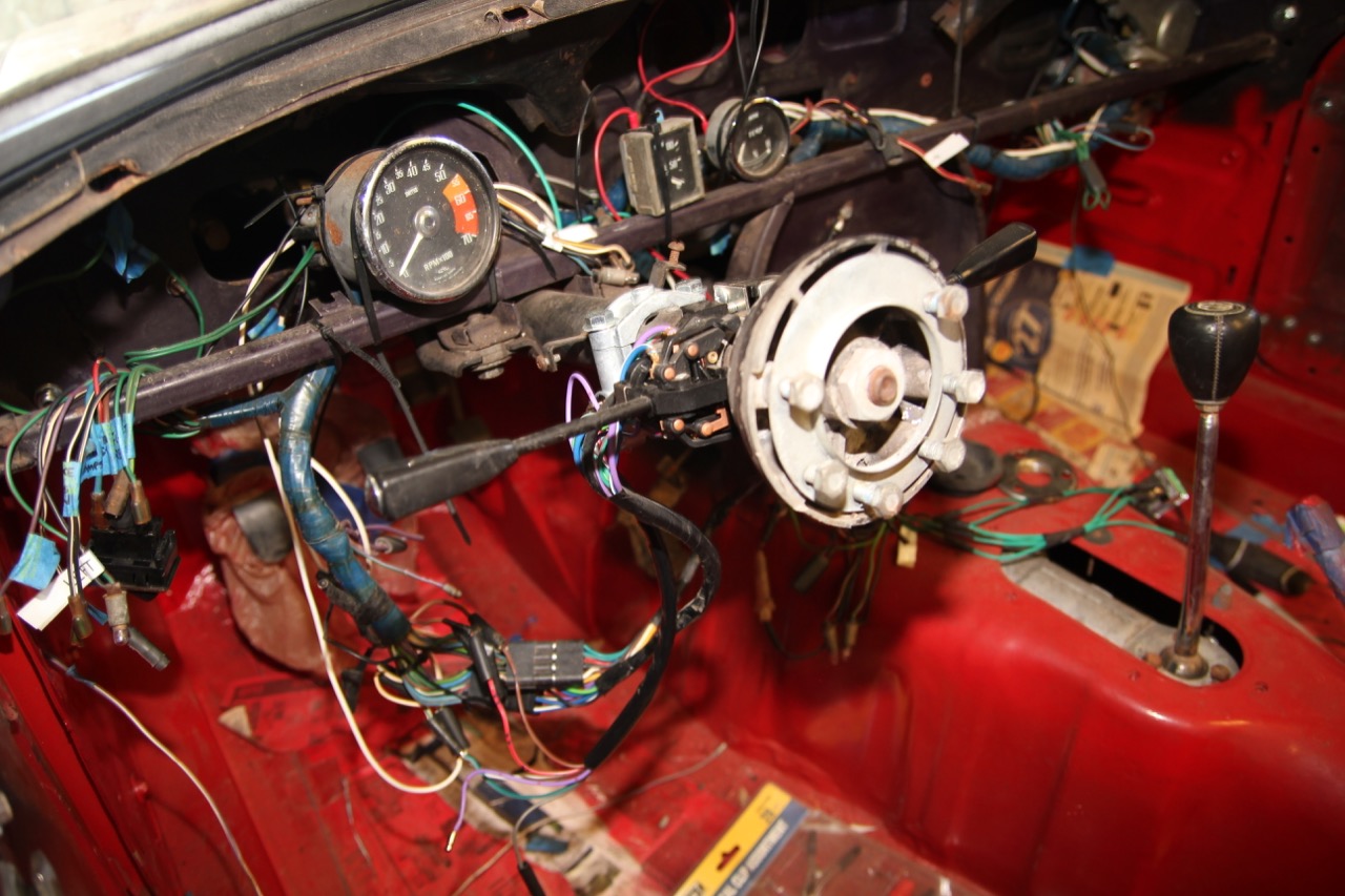

If anyone remembers; at the beginning of the year I had this - beautifully zip-tie mounted gauges and loose lamps dangling everywhere...

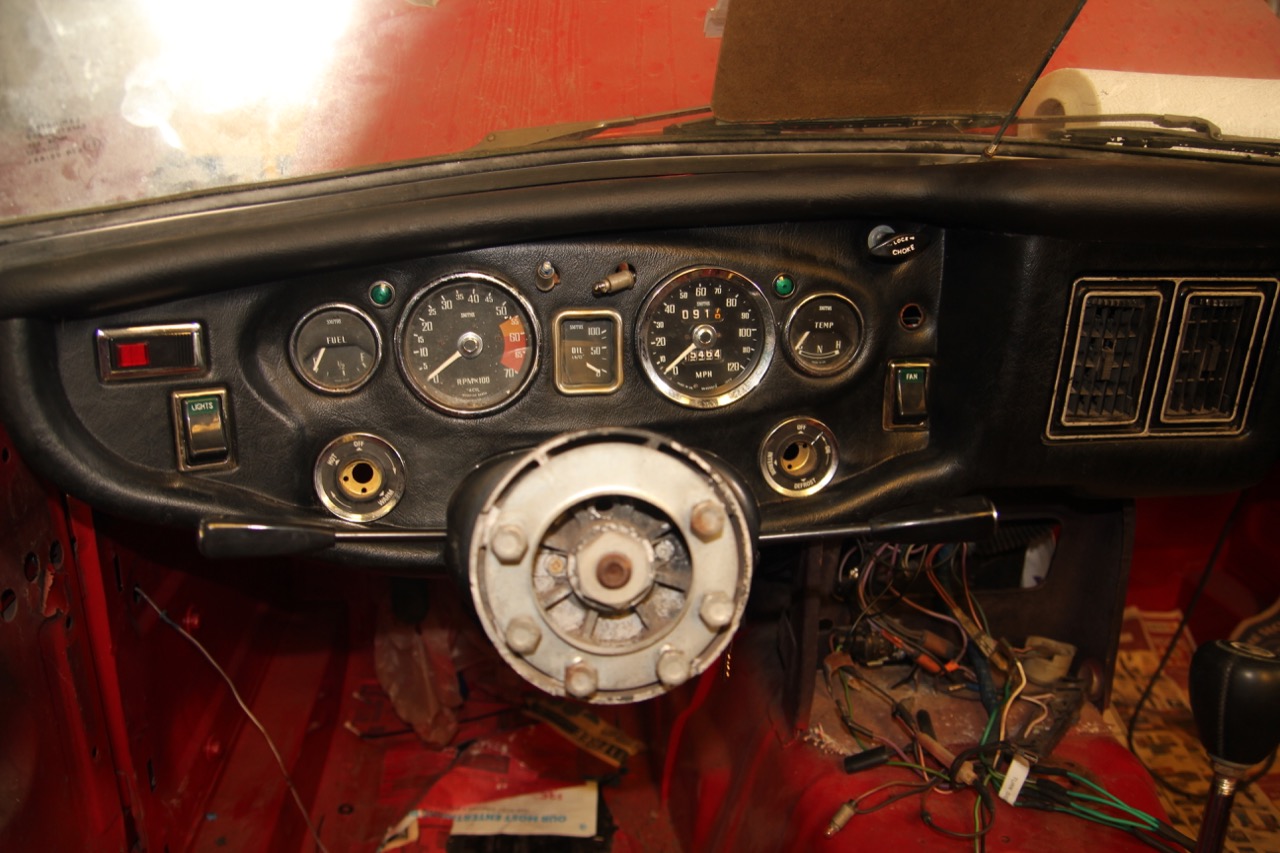

By June I got to this point - still a horrible mess where the center section should be and loose lamps hanging out from the panel because the high-beam and alternator warning lamp holders can only be obtained as $20.00 assemblies with integrated bulbs, and would require cutting off the original bulb holders to use. I'm not inclined to chop up the factory harness (although someone already apparently took a weed-eater to the center section).

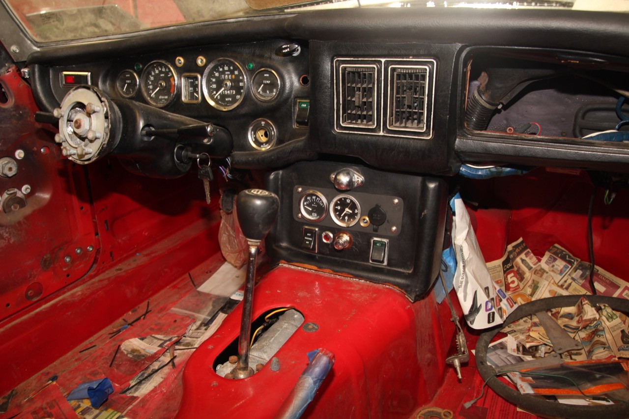

As of last weekend - this is where its at. I repurposed (without further modifying or damaging of the factory harness) a redundant seat belt warning lamp to become the overdrive selected indicator in the center panel. It was part of undamaged harness section but requires seats with the pressure sensors - my seats are from an earlier year without any sensors. I patched in a wire from the overdrive solenoid (using factory style bullet connectors) to that lamp. The custom solid brass lamp holders for the hi-beam, alternator warning and (now) overdrive selected indicator bulbs are actually old mobile home plumbing fittings that took a quick ride thru the lathe to turn them into a flush front flange. The bulb assemblies fit perfectly into the backside like they made for this (even though they weren't) and they are much more durable than the unobtainable factory plastic parts. They also fit perfectly into the existing panel openings with no modification needed. I just need to get some colored plastic to make lenses for them and I might redo the turn signal indicators the same way just to keep it all consistant.
I made a blanking plate where the original (and I don't have it) AM radio was supposed to be, and put the OD indicator, a second 12V outlet, clock and voltage gauge there. These cars didn't come with a voltage gauge which was always to me a shortcoming. I couldn't find an affordable genuine Smiths UK gauge from a different model car, so I went with something that looked close (and was the correct size) from the local parts store. The clock is an actual factory clock provided by one of the members here (THANKS!!!!!!) It was included in the 1976-1980 year cars, prior to 1976 no clock was provided.
At this point everything with the exception of the heater controls is functional (including all the backlights). I chose to use a factory headlight switch (same size) instead of the basic on/off switch for the map light. Now I can connect the map light to the first click connection, and then add some footwell lights on the second click connection. That way I get footwell lights without losing the original map light functionality (and again no modification to the hactory harness). The harness for the center section was already pretty chopped up by multiple previous owners but I've been using factory style bullet connectors for everything I changed which tie back into the undamaged main panel harness. The hazard lights wiring was just chopped out completely (I suspect someone 'harvested' the original 6 pin connector that is no available for purchase), so that wiring is not original style - but not visible either.
