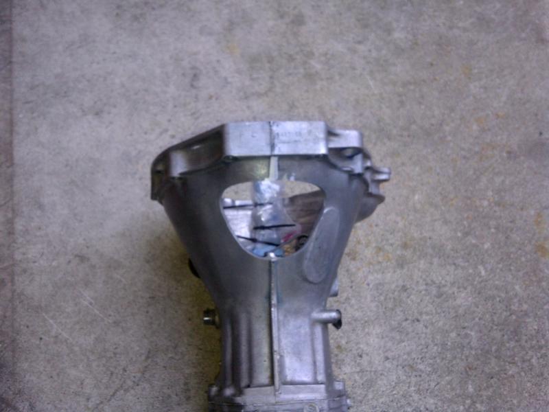

The fit is very tight above the heater box my Innocenti C even had less room so I had to cut out a section of the trans to get it to fit .
Cheers
Mark

If taking the cranshaft pulley off and reinstalling in place hadn't worked, then we would have been taking your approach. Thanks for the photo! DOug
