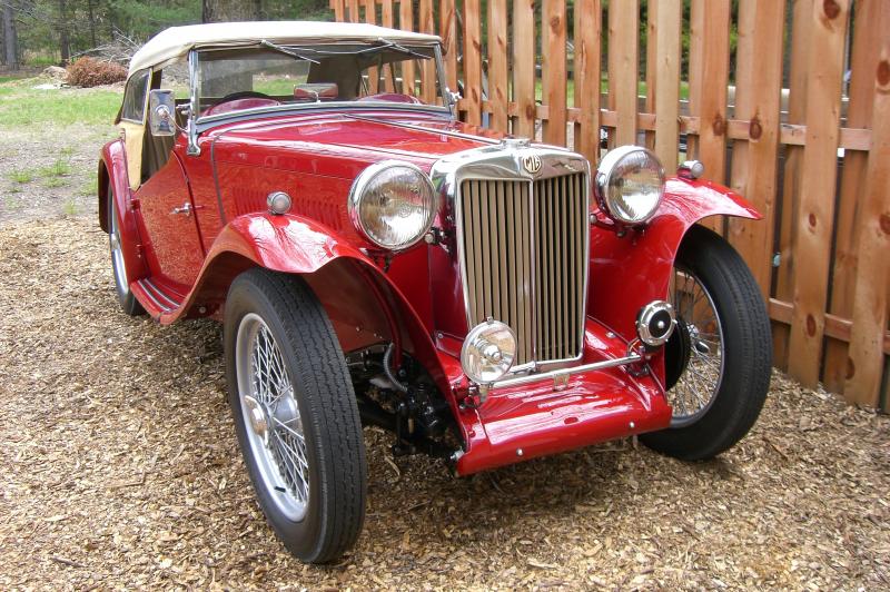

I've been finishing my bodywork and undercoats with DP40LF primer as a sealer for years now and never had and adhesion or telegraphing problem with the color. I'll reduce it 60% with a med temp reducer and spray a nice wet even coat over everything , then let it dry overnight. Wet sand with 600 and spray color. You really need that unbroken film to spray today's CIMG0006.jpg aint over for the best results. The tendency is to spray with the material too thick which makes it too hard to finish sand.
