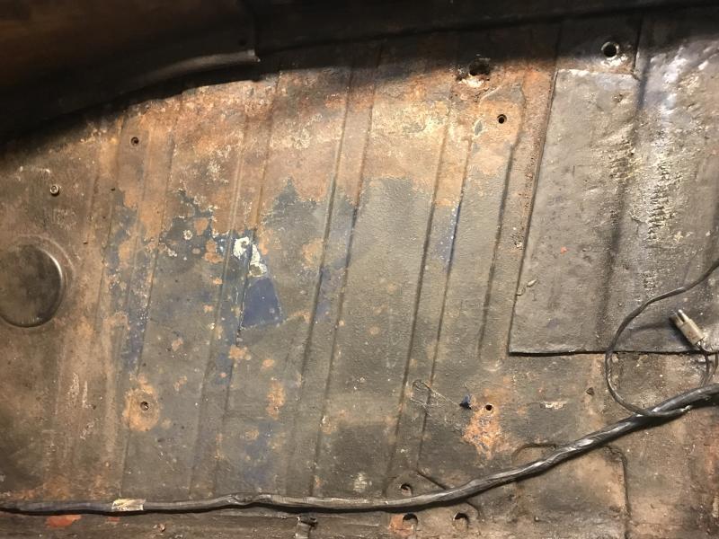

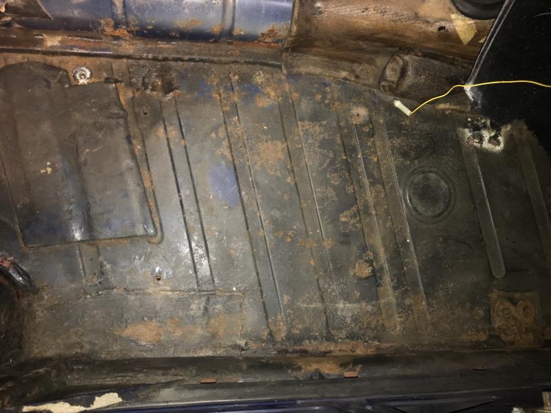

Most of the floors are in good shape and still have factory blue paint covered by a thin black coating. I will do what you guys said on the few surface rust spots, thanks. I'll try to post some pics today.
Thanks.
The coating could be contact adhesive.
You are lucky to have found a car that was that well cared for that the floors survived for 40+ years.
David
These are what i'm working with. Right side had small repair welded in- looks like it was done right.

Wish mine were that clean!
