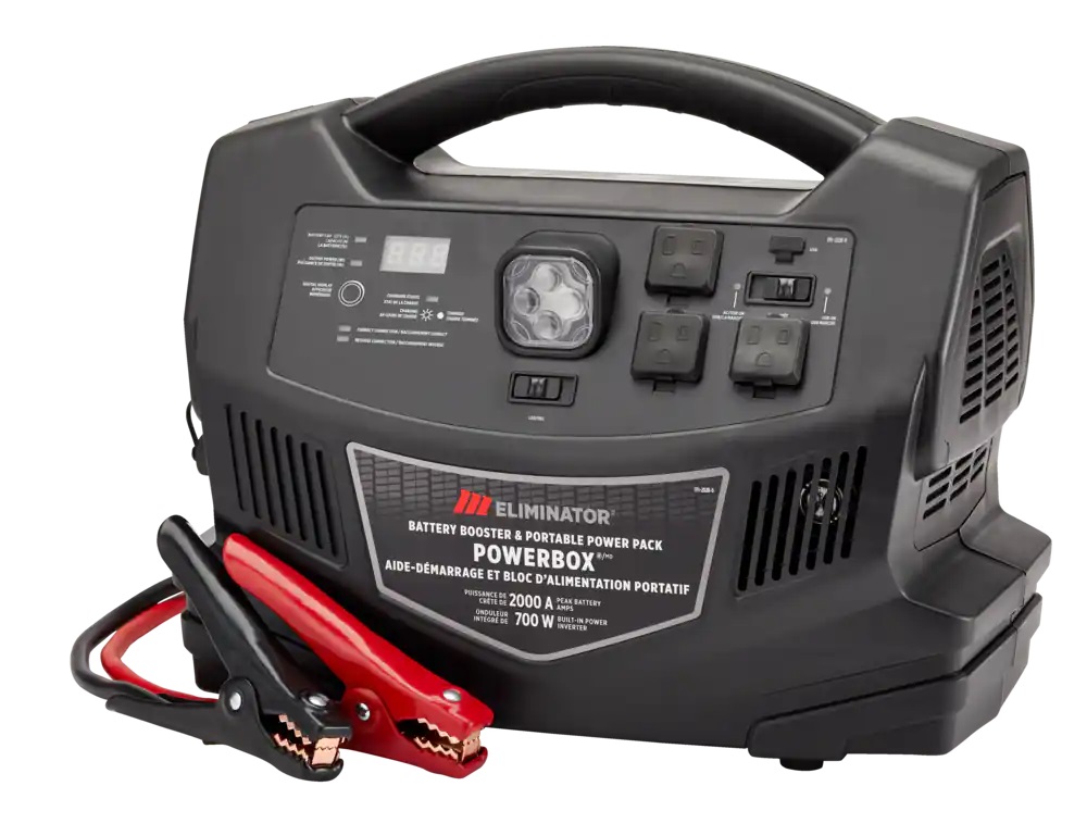

This leads me to wonder about power packs - Most of them look like this:
But a lot of the traditionally shaped ones seem to also have things like compressors (which I don't need)

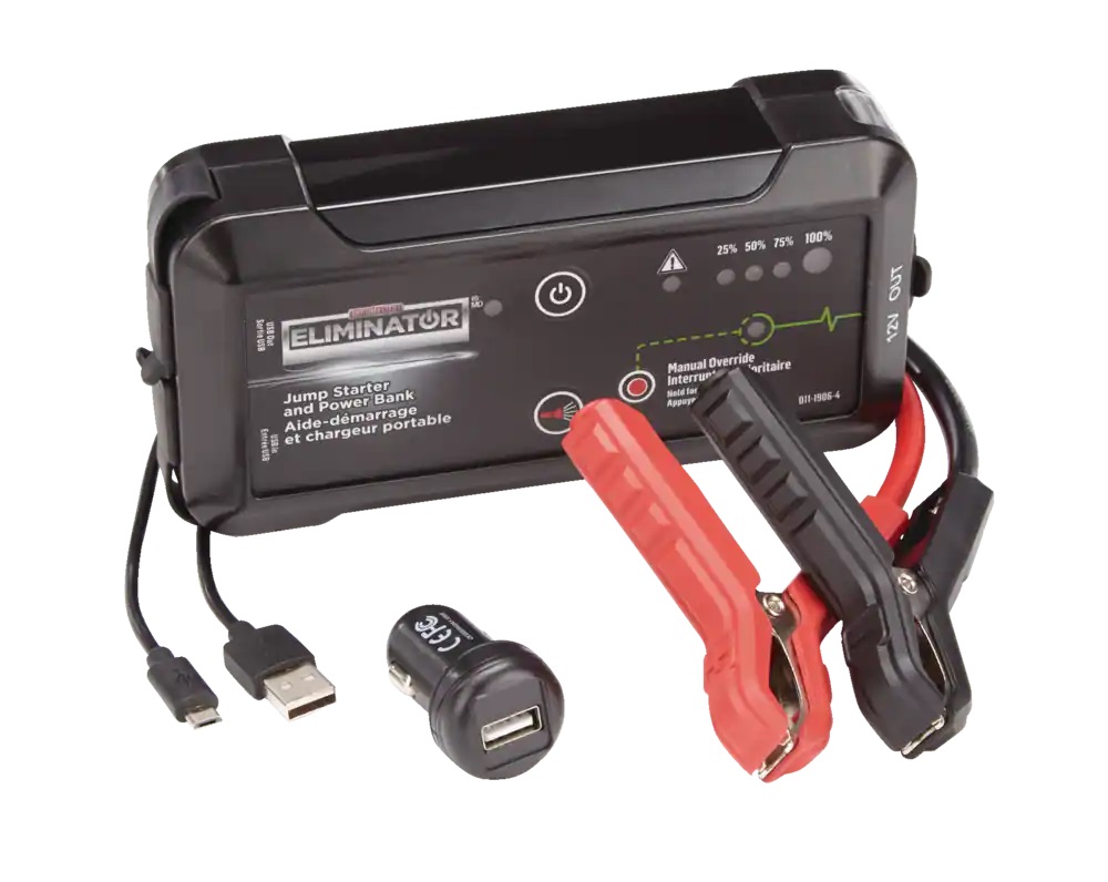

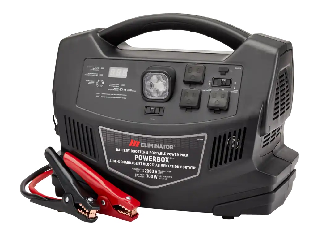

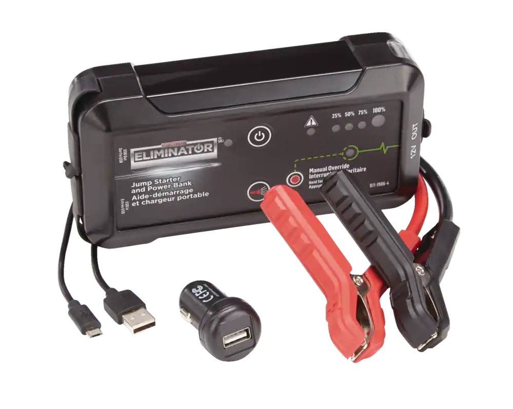

But, recently I have also seen the more compact ones like this:
Has anyone had experience with these? any thoughts?
Hi JP I haven't personally but if it is lythuum my friend has one in his glovebox, has used it quite a few times to start people's cars. He swears by it.
The advantage of lythuum is it will not go flat when not used, unlike sealed lead acid batteries

JP - I don't think the devices in your photos are meant to be used for charging a low car battery. Jump starts only.

The top one is sealed lead acid battery, Had them in the past, if you dont keep them on charge they slowly drain out when you need it, the darn things flat, to a point they will not charge up again, I personaly would not give one of these types of boosters garage space.
The bottom one is lythium, holds charge for long periods of time, always ready to go, I have lythium drill batteries that have stood for six months and still fully charged.
the top one is 2000 amps when fully charged, the bottom one is 750 amps, hense the difference in price,
