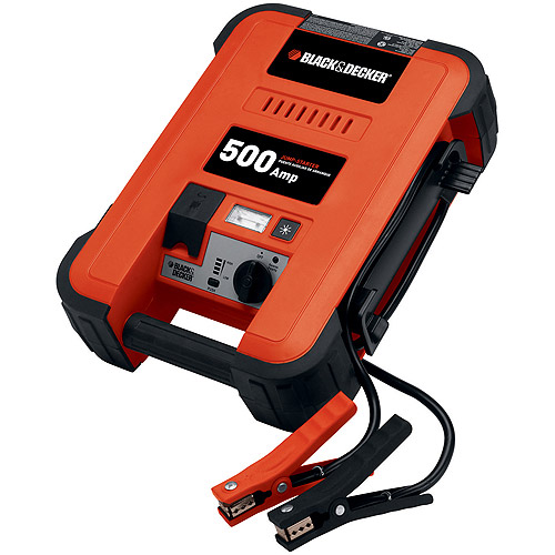

Power pack to charge cell phone?
David
Thanks David. Never even thought about alternatives for cell charging, but just remembered my B&D battery box has a built in USB port for charging.

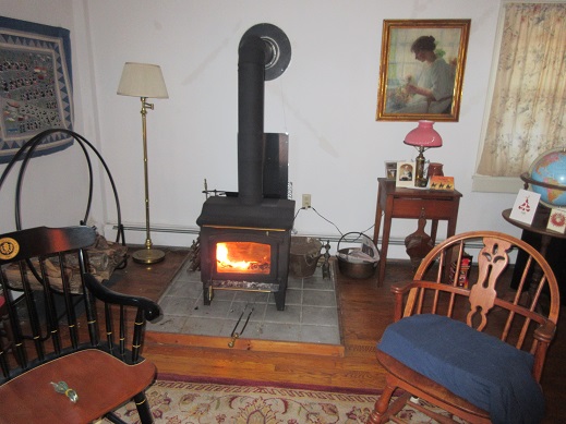

We have a fireplace, so one room would be warm enough to live in - plus roast some hot dogs and make popcorn.
Thanks gents. I've got a generator to keep the furnace running (oil heat). And a woodstove to keep things toasty if the generator conks out.
Main concern was the hydronic (hot water heating system (convectors along the bottom of the walls). If the generator were to fail, the furnace wouldn't run. Furnace not running, the pipes get cold. Woodstove keeps the pipes in that room fine, but all the rest of the house would need draining. argh

You might give it a try before going too overboard. Heat will circulate amazingly well if you have enough differential; so odds are good that if you can keep one room at 70F with all the doors open, the others will stay above freezing.
That is a *great* idea. When the woodstove is going, that room get to 75-80F. I usually have to open the doors to the rest of the house to "share the heat". That's definitely my plan of attack now, if the power goes out and the generator fails. Never even thought about the air circulation and temp differential factor.

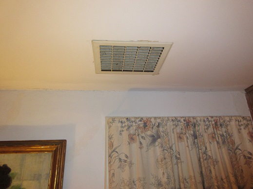

Pay attention next time you are in an older house. Unless they've been remodeled out of existence, you'll probably see a flue cover on the wall in almost every room on the ground floor. That's because they used wood stoves for heat, without fans or power burners, etc. A 2 story house will then have vents through the ceiling, to let the heat rise upstairs.
Dad's house originally had 6 or 7 different chimneys, some of them with 2 or 3 flues. But none of them are still in use, and they haven't been replacing them after accidents, etc. so I think there are only 2 left above the roof.

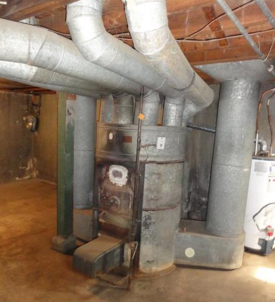

My great aunt's house had a somewhat more interesting (to me anyway) arrangement : "gravity air". It's like forced air, with a big furnace in the basement, but no electric blowers. The heat circulates only by convection. The present owner had it replaced with forced air, though.
Uh-oh - looks like it's time for a remodel. Here's one of the ceiling vents in my 1826 house, above the wood stove.

Randall, does this "gravity air" octopus look familiar?
