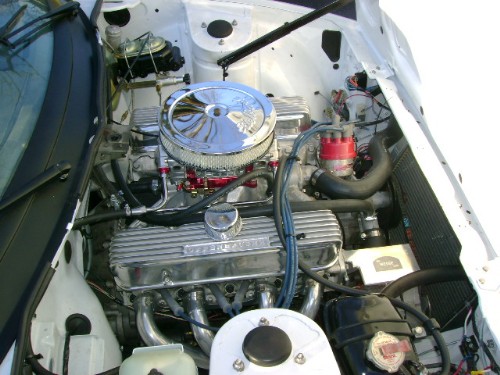

On the cars with big brake kits front and rear, it is common to go to masters with a larger bore. The last one I did was a 1" bore crome hot rod unit derived from a Caprice. It was a heavy cast unit, and I had to enlarge the holes in the firewall slightly to bolt up the booster. I didn't want to install it, but it wasn't my call or my car. I prefer to use a Willwood aluminum unit bolted to the stock booster. The bolt spread pattern is a common one, but there will ineviteably be some fabrication involved. I wouldn't change unless you need to use a larger bore master to push more fluid into larger bore calipers. It just isn't worth the work. New TR7/8 masters are available again, and the boosters can be sent off to be rebuilt. The TR7 and TR8 use the same masters, but TR8 boosters are larger than the TR7 ones. If you do decide to change, make sure you get a master with a dual resevoir. If you are keeping stock brakes, you should maintain the same bore size in the new unit. You will also have to order brake line adapter fittings, and more than likely, you will have to fabricate a push rod. One more thought- used ones are easy to come by. I must have at least a dozen of them rusting away in the back of the garage.
