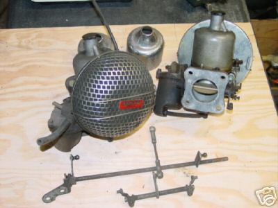

Attached is another view of the carbs.
hi, those are definitly the hs6 carbs and yes they look like they came from a volvo. they will bolt right up to your manifold. these are the same ones i started with. like i said i would change the float bowls to the spitfire sloat bowls so they sit correctly and wont create that flat spot or richness that someone mentioned earlier.
Randy
Hello Jm,
it is not the float bowls that need changing, but the adapter between the bowl and the body. I would also suggest that you will need to adapt your existing linkage with the Volvo? links. It should not be a big job and as I said earlier, obtain the suggested needles.
Alec
Just FYI, the clearance on the underside of the bonnet/hood with the front dashpot cap might be marginal. That has been my experience with the SU H6 carbs. I can close it OK but there's some rubbing, which I have addressed using sundry 'buffer' type setups. You might want to check that out before sending them out, and/or be careful the first time you close the bonnet after installation. Just a thought. Pete
