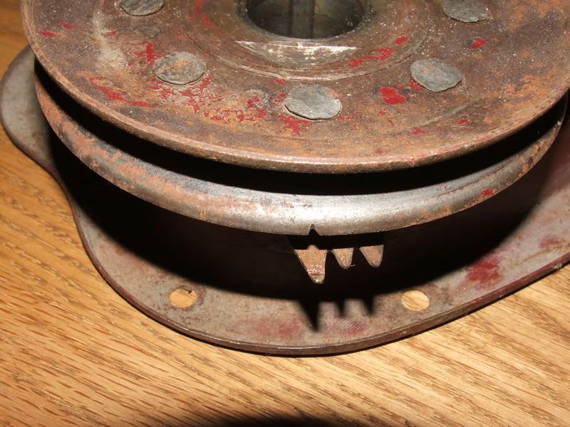

'75 B, 18V engine... If the diz went in to it's seat you did that correctly. The timing marks may be a different story. I don't have a "modern" (18V) set of manuals, but the "early' (18GB) engines have the TDC pointer dead-center bottom of the pulley. Four "teeth" for reference and each "tooth" to the right (engine turns clockwise looking from the front) represents 5 degrees BTDC, with a larger one at 15 degrees. You seem to be off by at least 5 degrees, if the two engines are the same (and I believe they are).
HTH!
YES Dave. The TDC "tine" of the set of "teeth" would be consistently the one most to the "left" viewing it from the front of the engine. The rest are in 5 degree increments.
So this would be 0 TDC
BTW....This is a 1622 chain cover
Yup. According to All That is BMC, that's the only TDC I've ever known. The other two teeth are at 5 degree increments before it.

Wow, that's it, spot on. Good job. Now get those parts blasted and painted while you can get to them.
It's kind of hard to see but, the pulley rivets have been /ubbthreads/images/graemlins/hammer.gif
After going through 2 pulleys, I decided to get a billet one.
(One part full-proofed, about a gazillion ta go)
Also.....I brazed a timing mark indicator on the TOP of my other timing chain cover.... /ubbthreads/images/graemlins/yesnod.gif.
Good move with the timeing mark.
Looking at "whatsthatnoise" picture I don't have a larger tooth like that, all mine are small. I will recheck the timing this weekend and let you know.
