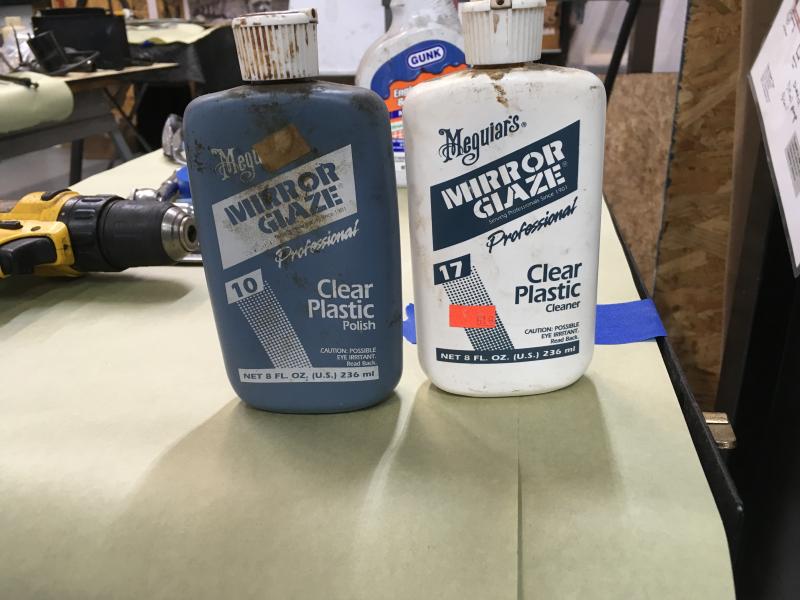

i have used this stuff for years. have no idea where i bought it. i can't say the cleaner does a real good job but the polish seems to work nicely on the rear window. used it on many cars.

Been using the Meguires for years, works OK. Now that I saw how easy a replacment can be made (on Wheelr Dealers), might be the route on browned plastic. Just need a walking foot extended arm machine. $150 replacement for trim shop, would need 6 tops to do to pay for machine.
