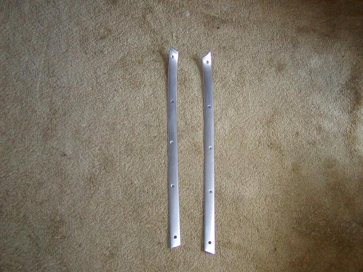

A Dremel tool with a 120 grit flapper wheel is very easy to control on the Aluminum bits. Takes care of scratches very quickly. These were in very rough shape.
Very nice. I did one of mine by hand with varying grades of sandpaper. I do have a dremel but I didn't think to pick up a flapper wheel and use that. Excellent suggestion.

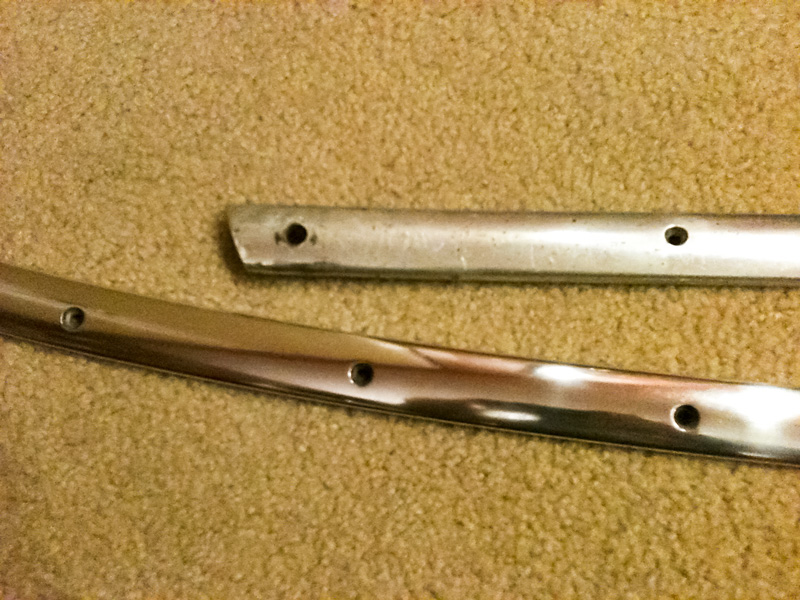

Polishing and anadizing was about 300+ bucks.
Here is the finished product next to an unfinished piece.
