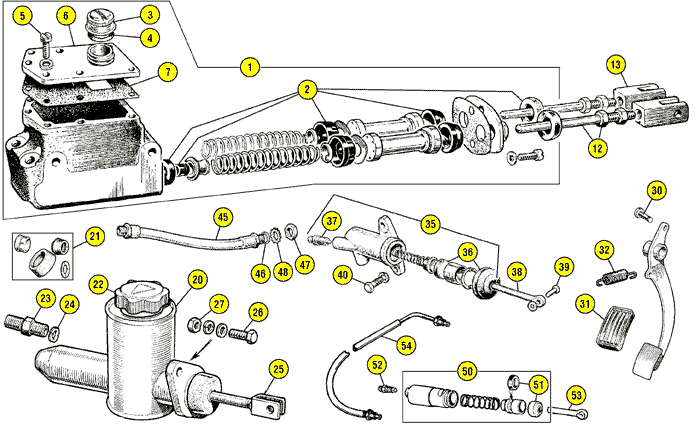

Oh, and Mike, I will try what you are saying. I have pushed the piston up to remove fluid out of the slave through the bleeder. Why do I have to remove the dust seal and push rod on the slave? The dust cover is what holds the piston in place. If it is removed it has the possibility of slipping out. Couldn't I just use the push-rod and keep the dust cover in place and do the same thing?
The piston is retained in the slave with a circlip (see attached diagram), so I had no problem with it falling out. I guess you could try to compress the piston with the dust cap and push rod in place. I found it easier just to use a easy- to-hold nutdriver handle to do the pushing. You do have to undo the clevis pin to let the piston fully expand. When I did that, the pushrod and the dust cap pretty much just fell off anyway. With the clevis pin in place, the piston is held back by the clutch springs, so you'd never get a full stroke. The idea of the full stroke is to move enough fluid to clear all the way back to the MC.
