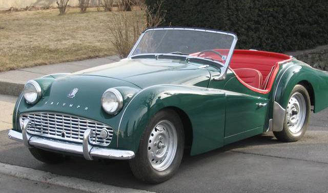

I just finished a TR3A with Dupont Triumph Racing Green listed as a 1964 colour, See atachment. Let me know if you want me to forward the Dupont formulation mix.
Hee is the photo
"Triumph Racing Green" is also known as Conifer and as Triumph's paint code #25.
