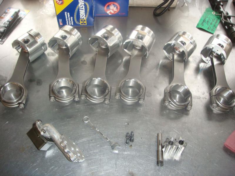

Eye candy...
The smaller set of 100/6 pistons are in the car Jim restored, and the bigger ones are for Quick's 3000 (anybody heard from him lately?)

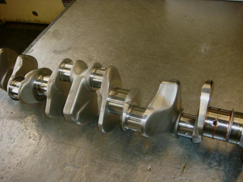

Ok Randy's showing off the candy now...
