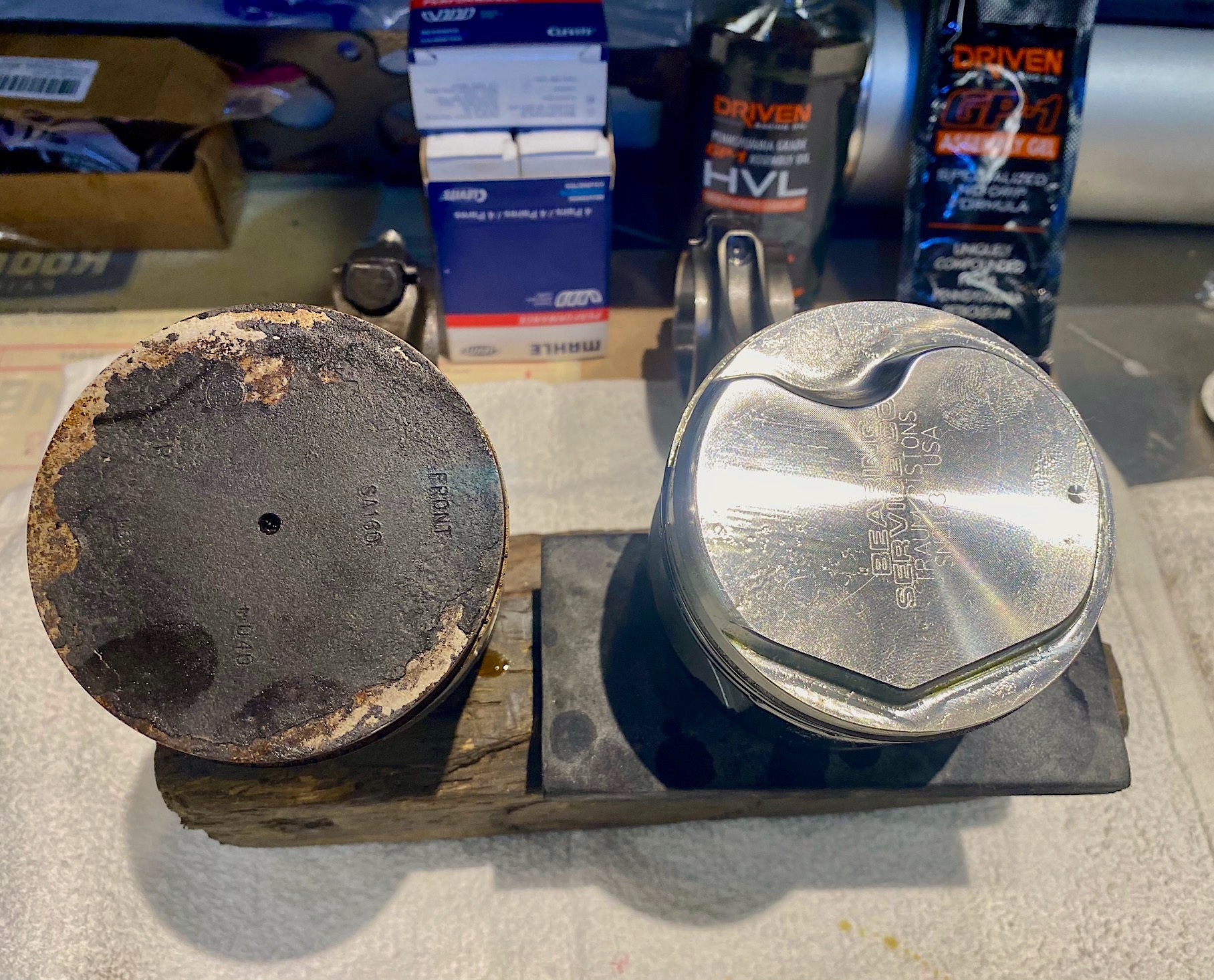

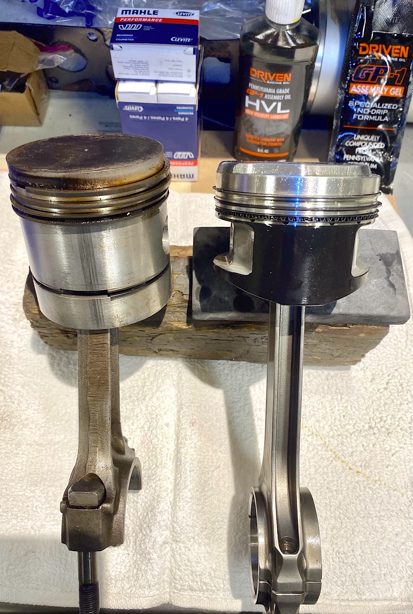

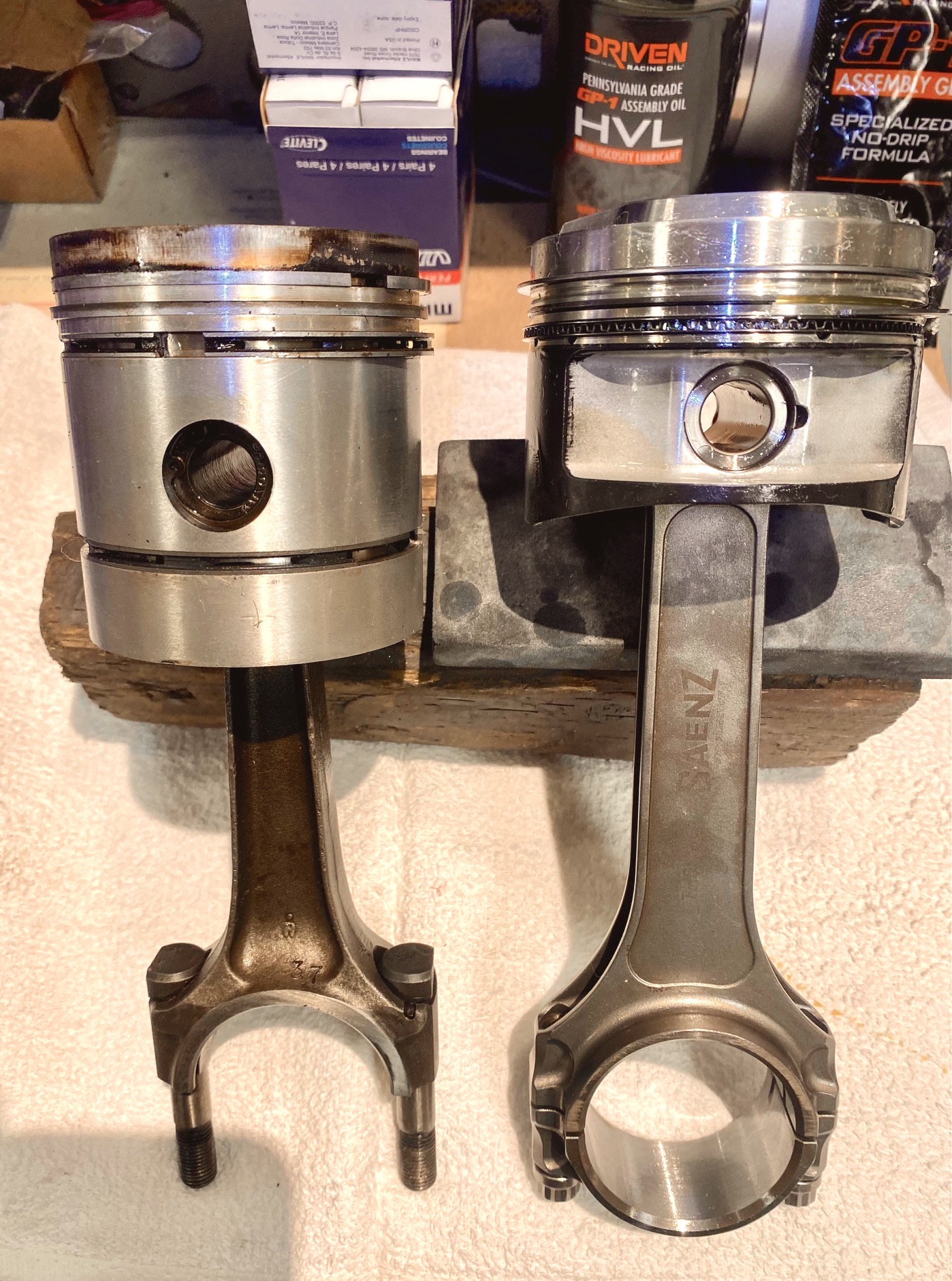

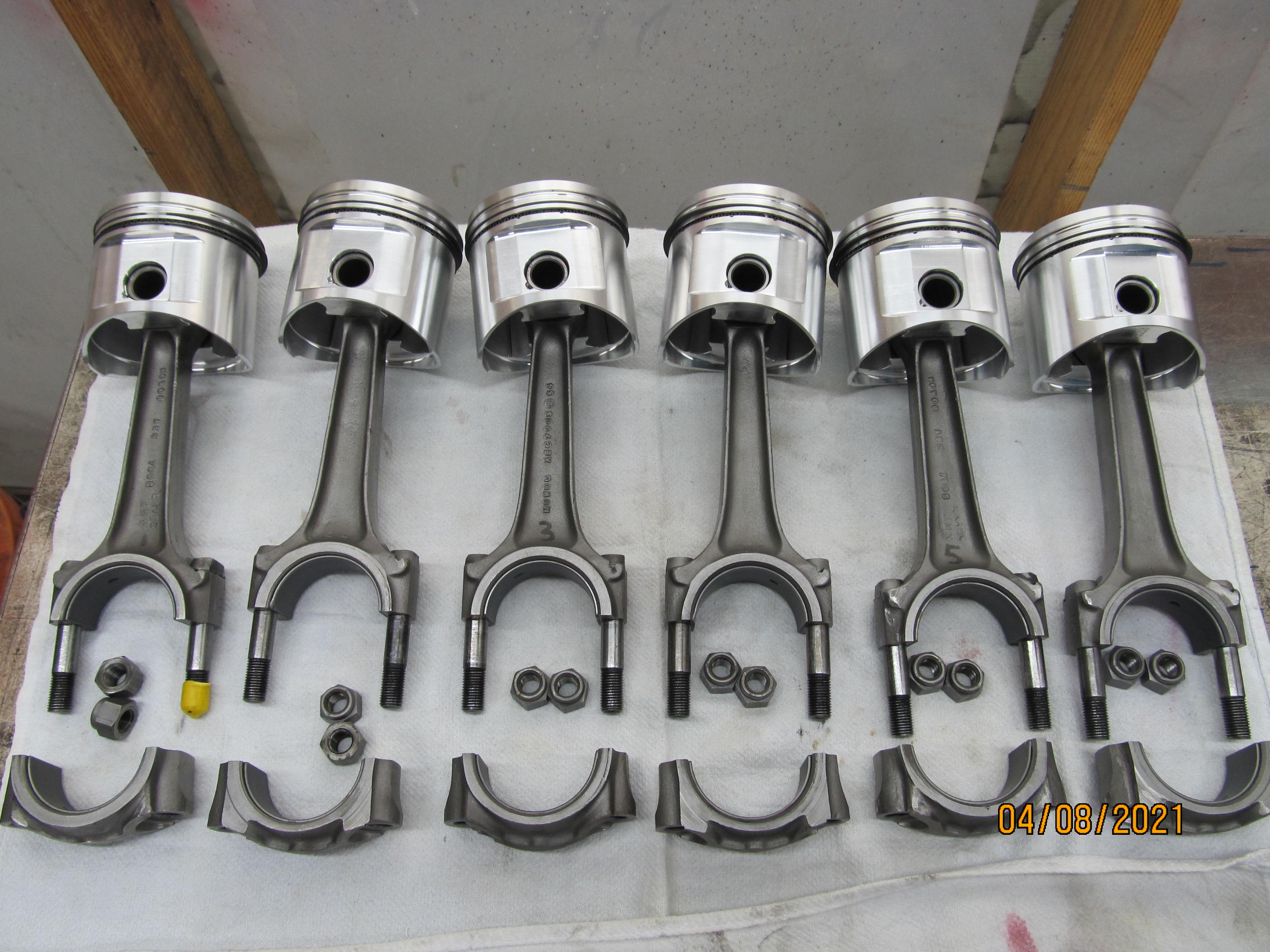

Thought I'd share a comparison between the OEM piston and rod system and what now can be used to obtain the highest level of performance.
The difference between the stock piston/rod and a high-performance piston/rod combination is 10oz. in weight, and a whole lot more total real performance (horse power & torque).
The 'skinny' rings have to reduce friction quite a bit, too, and probably reduce bore wear. Most/all new cars have similar, the downside being possible higher oil consumption. Manufacturers often claim 1qt/1K miles is 'normal;' i.e. not cause for warranty repair (typical or worse than a well-built Healey engine).

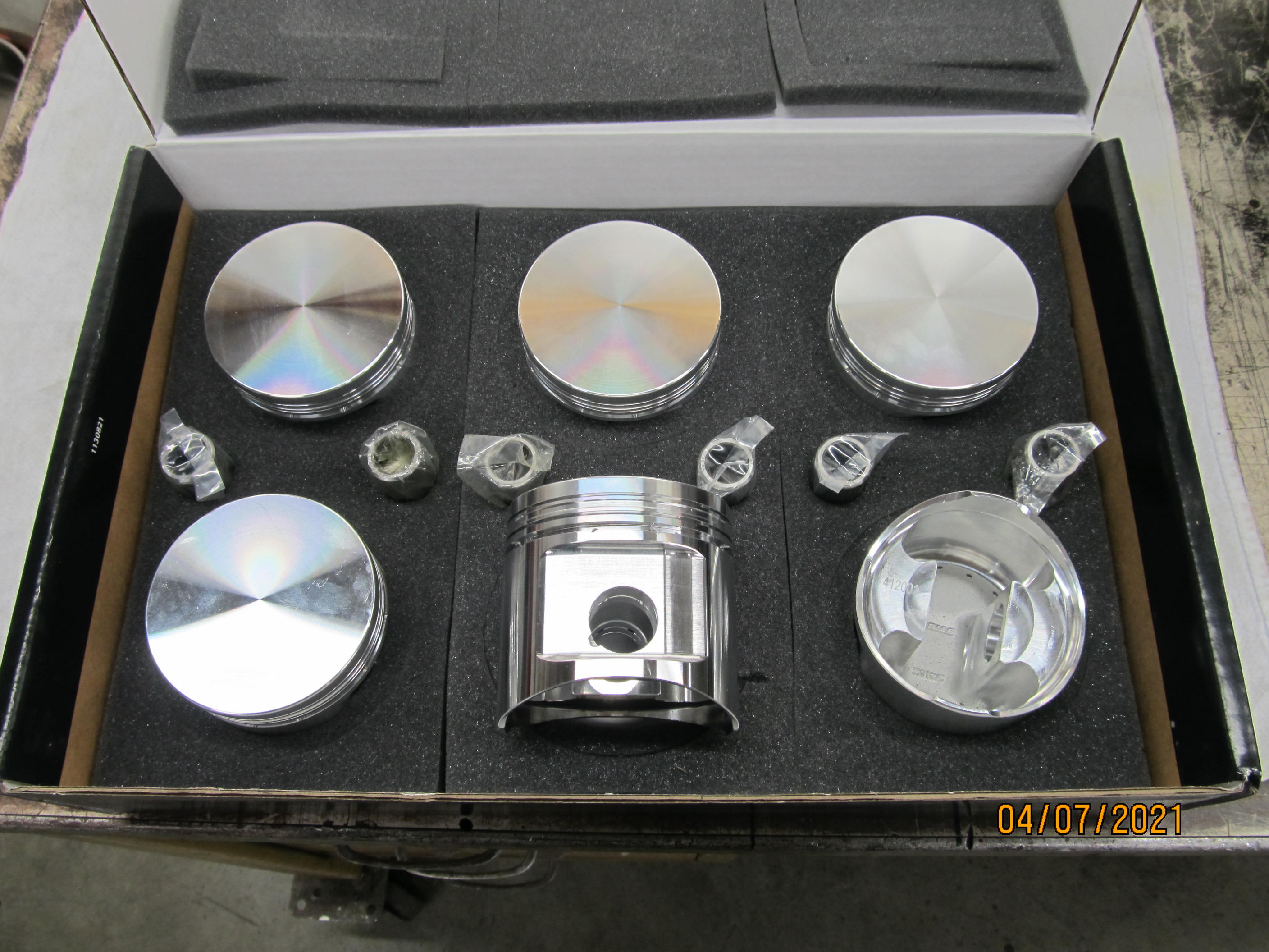

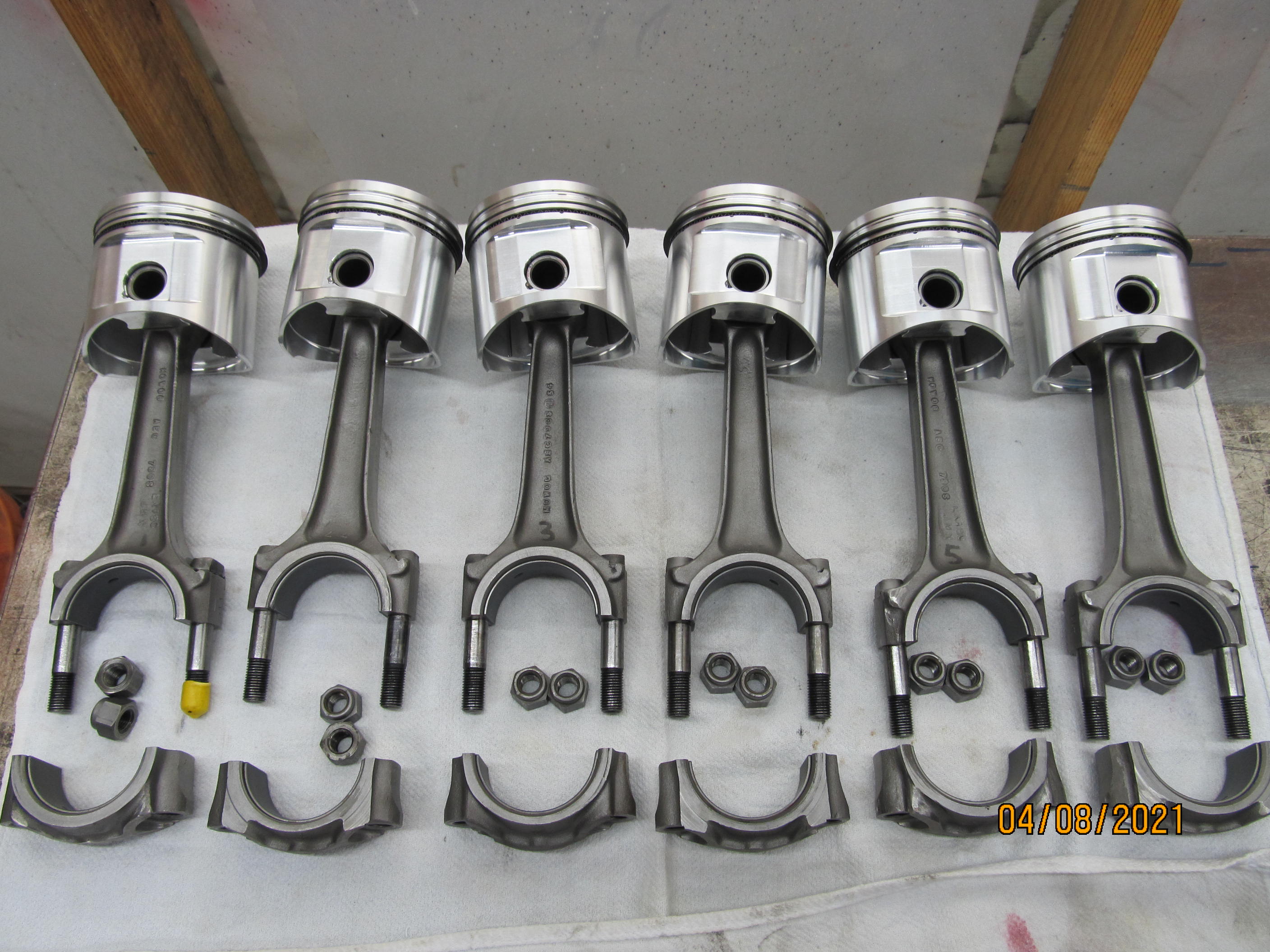

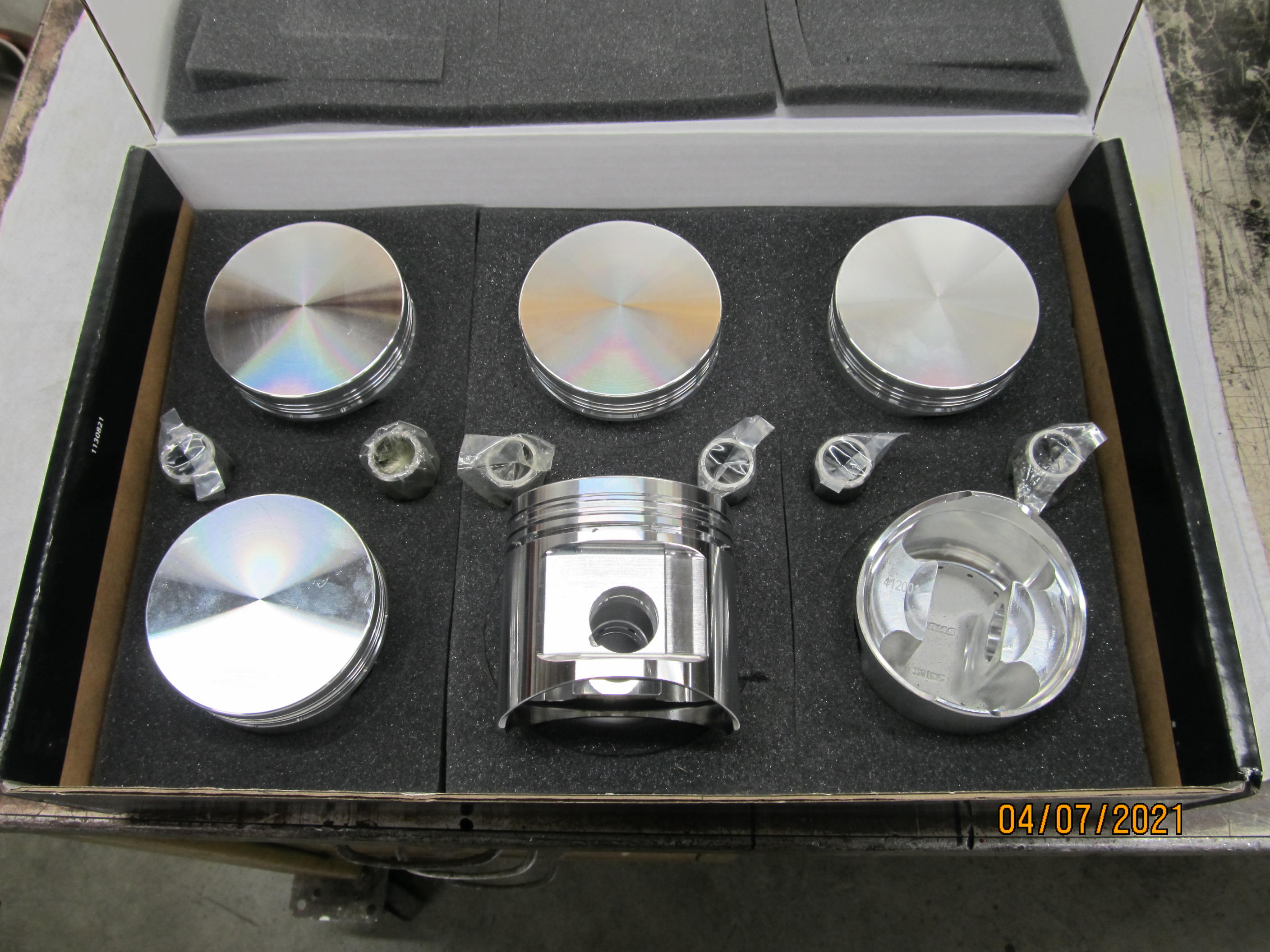

I agree with Dougie, However, there are less extreme options than Dougie's for a street car. I used Carrillo pistons and rings in my new motor but kept the stock rods (much cheaper:smile:). The Carrillo piston/ring/pin set saved 5.1oz from stock piston/ring/pin set. And total cost for set was $835 vs Moss list of $489 (an extra $350). Bob is correct about much less parasitic drag and cylinder wear from 3 thinner rings.

Dougie, I would expect an anti-scuff coating (dry-film lubricant) on the skirts, but I'm surprised they don't have a thermal barrier on the crown.
Edit: but those pop-up pistons and rods sure are pretty!
Adding an oil shedding thermal dispersant to the undersides, well that's just gravy... ;)

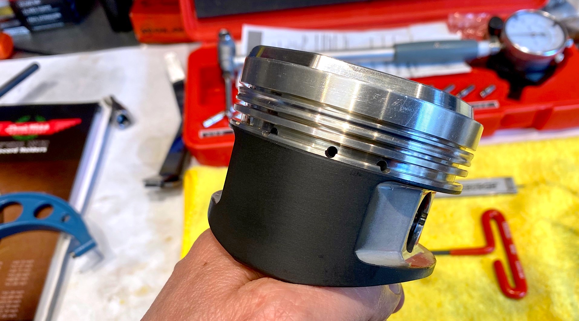

The S54 engine I just built using store-bought Mahle Power-Pak pistons meant that I didn't have to do the polymer coating process myself!

The skirt coating was something I added after receiving the pistons from the custom manufacture. I'm still not convinced on the long term life cycle of a thermal barrier on the crown/dome on a race motor. The NASCAR, NHRA, CART, etc. guys tear down their motors 10:1 to me and I'm really trying to make it 50:1.

I agree with Dougie, However, there are less extreme options than Dougie's for a street car. I used Carrillo pistons and rings in my new motor but kept the stock rods (much cheaper:smile:). The Carrillo piston/ring/pin set saved 5.1oz from stock piston/ring/pin set. And total cost for set was $835 vs Moss list of $489 (an extra $350). Bob is correct about much less parasitic drag and cylinder wear from 3 thinner rings.View attachment 86916View attachment 86917

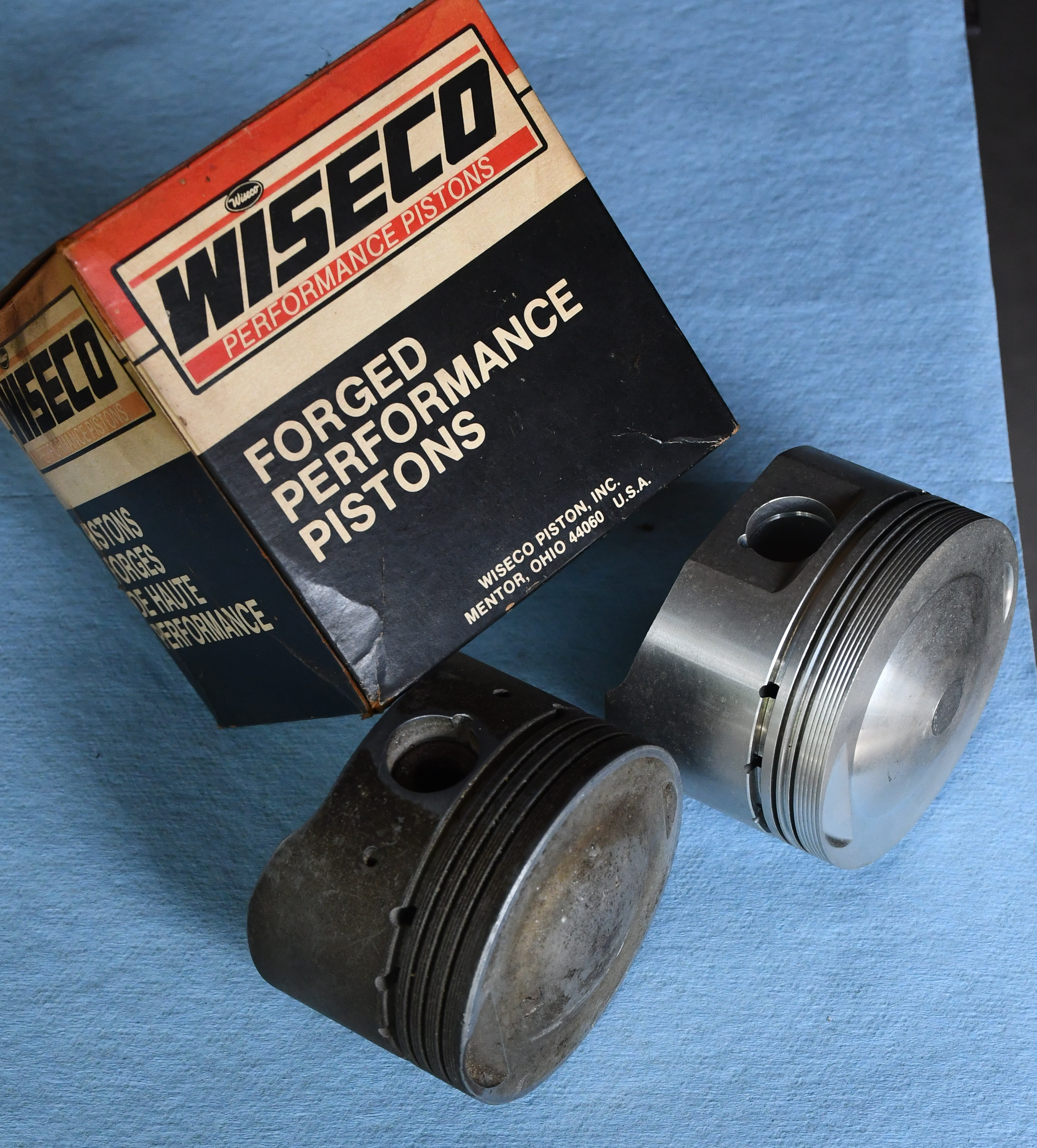

RE: That WISECO article, last V-12 Ferrari engine I rebuilt got Wiseco pistons. They sent us 13 for some reason, so that's here as a conversation piece. One of the old ones (stamped #12) is currently on my desk in the garage as an ashtray. 😏
Ferrari wanted some astronomical amount and a wait of months. Wiseco was a few hundred and six weeks, IIRC.
