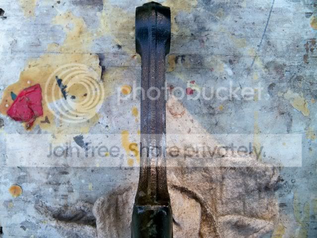

Personally I don't think it was hydraulic lock. Because: The rod is completely straight - sort of. Maybe it isn't but it looks like it's not bent.

Here's the rod from another angle

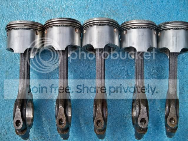

And the remaining 5 AE pistons which won't be used again either.
Hmmmm, five used TR6 pistons that could be made into "the killer 1500" build.
Are they flat tops?
Somebody talk me outta this quick.

Sure looks tweaked to me. The casting line isn't straight.
Re: Piston... MIA
I'd wouldn't be surprised,
Just think of the force it took to pulverize that piston. And you know it must have gotten lopsided when a piece of the piston got jammed and against the wall. Made a heck of a rattling racket,I tell you that..
