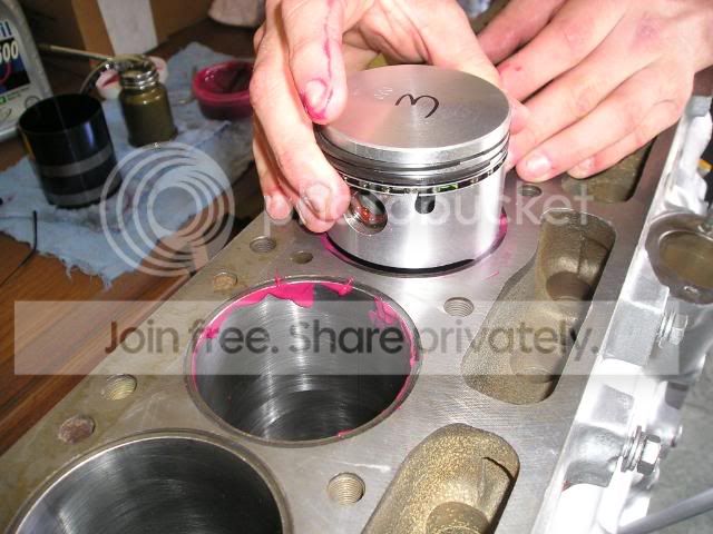

Number three piston held in positon to be placed:

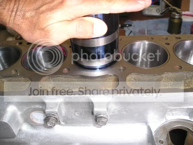

Unsuccessful attempt to install a piston. Ring(s) push
wide of cylinder walls stopping piston from being tapped
into place:

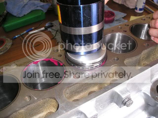

Pic shows ring compressor well placed around piston and
rings so thereafter, the piston can be tapped into the
cylinder:

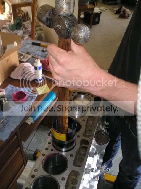

Piston being tapped into place:

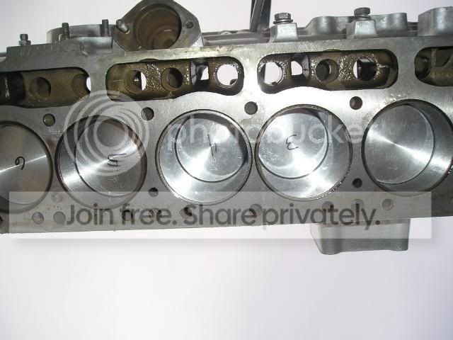

Pic showing five out of six pistons in the block.
Broke a piston ring building the piston set and have
another on order. Will install the last when the part
comes in:
