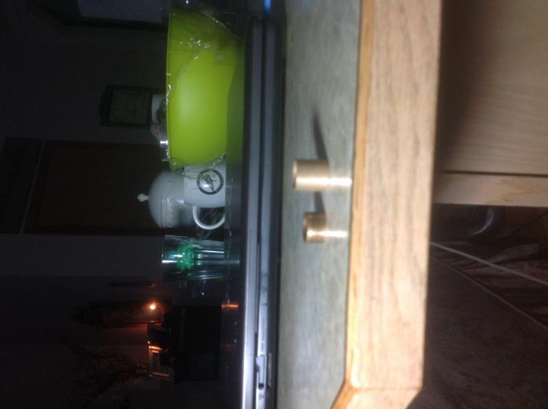

image.jpgHere's a photo of the two. The short one is the one that fell out. I can't think of why they would come in two different sizes. The new one is .005" larger in diameter as well, so hopefully that will solve my problem. I'm curious as to how it's going to fit, given it's longer length. I'll check with the supplier and see if it's oilite.

The longer one is correct, I don't remember ever seeing the short one before

thanks Bill,
my guess is I was sold the wrong bushing last time. I put the new one in last night with the loctite idea from Gerard and the grease soaked felt idea from Keoke:smile:.
