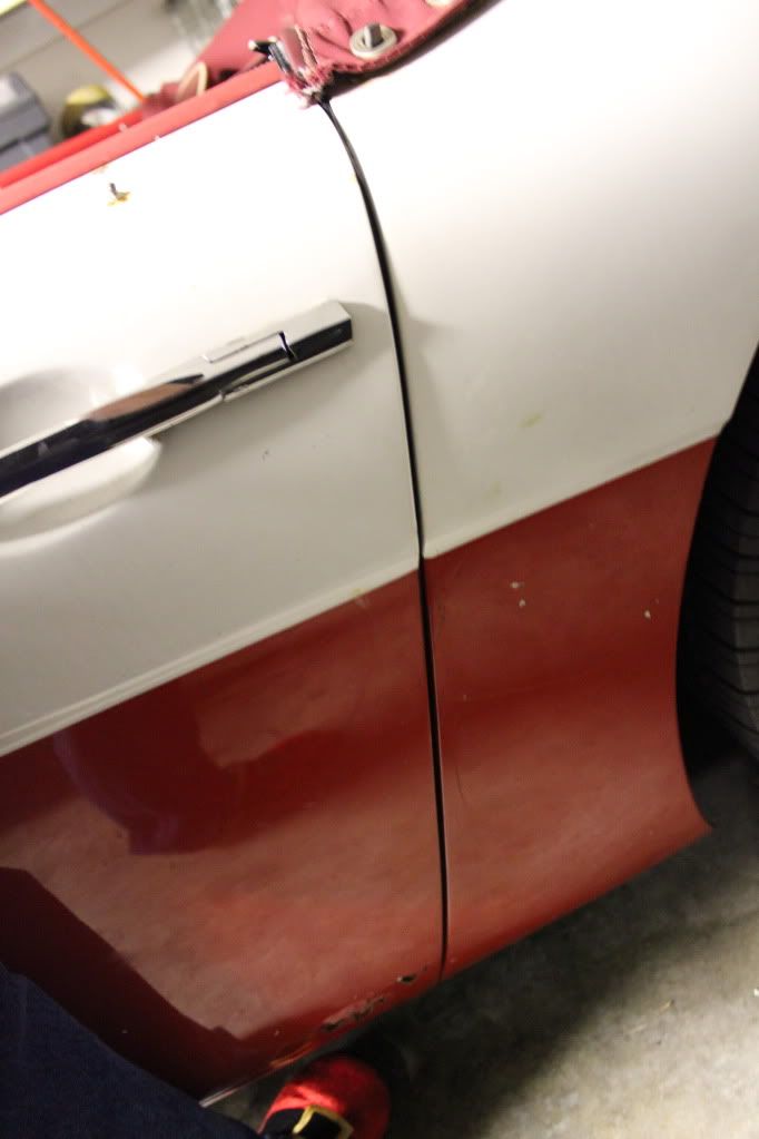

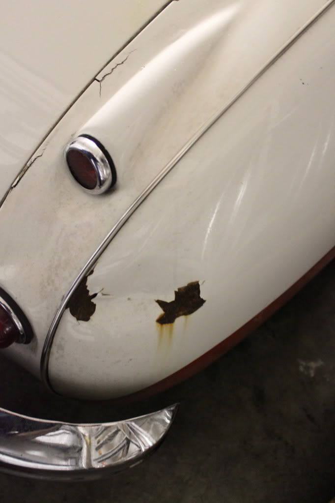

pics of my bt7

Mine started out just about where yours is, but with no holes in the doors or fenders. I didn't want to take off the shrouds either. It ended up looking like this after the first round of painting at the body shop:

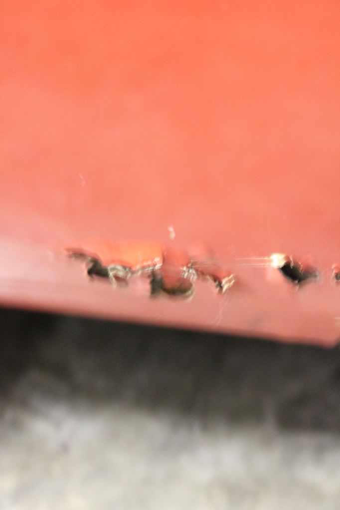

Well, so the cancer is deeper than originally thought? At least yours is running and the engine compartment looks great. I have a few suggestions too, which may help:
