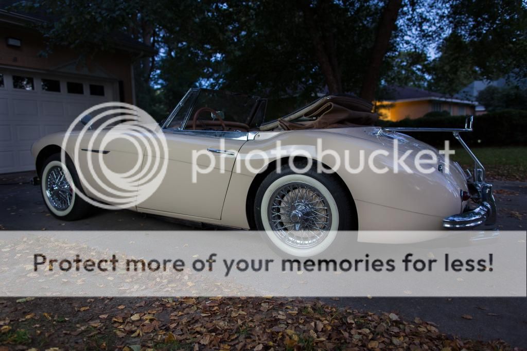

On to the pics. I took these a few days ago after the Healey had sat for probably 2 years. My youngest daughter had never even been for a ride, and the weather was cooling off where you didn't get cooked so badly from the heat of the engine/exhaust, so I decided to get her running again and take the kids out. I knocked the layer of dust off with some quick detailer, but did not wash her. She will look even better with a fresh coat of wax :smile:
20141005-074B0350.jpg20141005-074B0345.jpg20141005-074B0340.jpg20141005-074B0352.jpg20141005-074B0344.jpg20141005-074B0368.jpg
