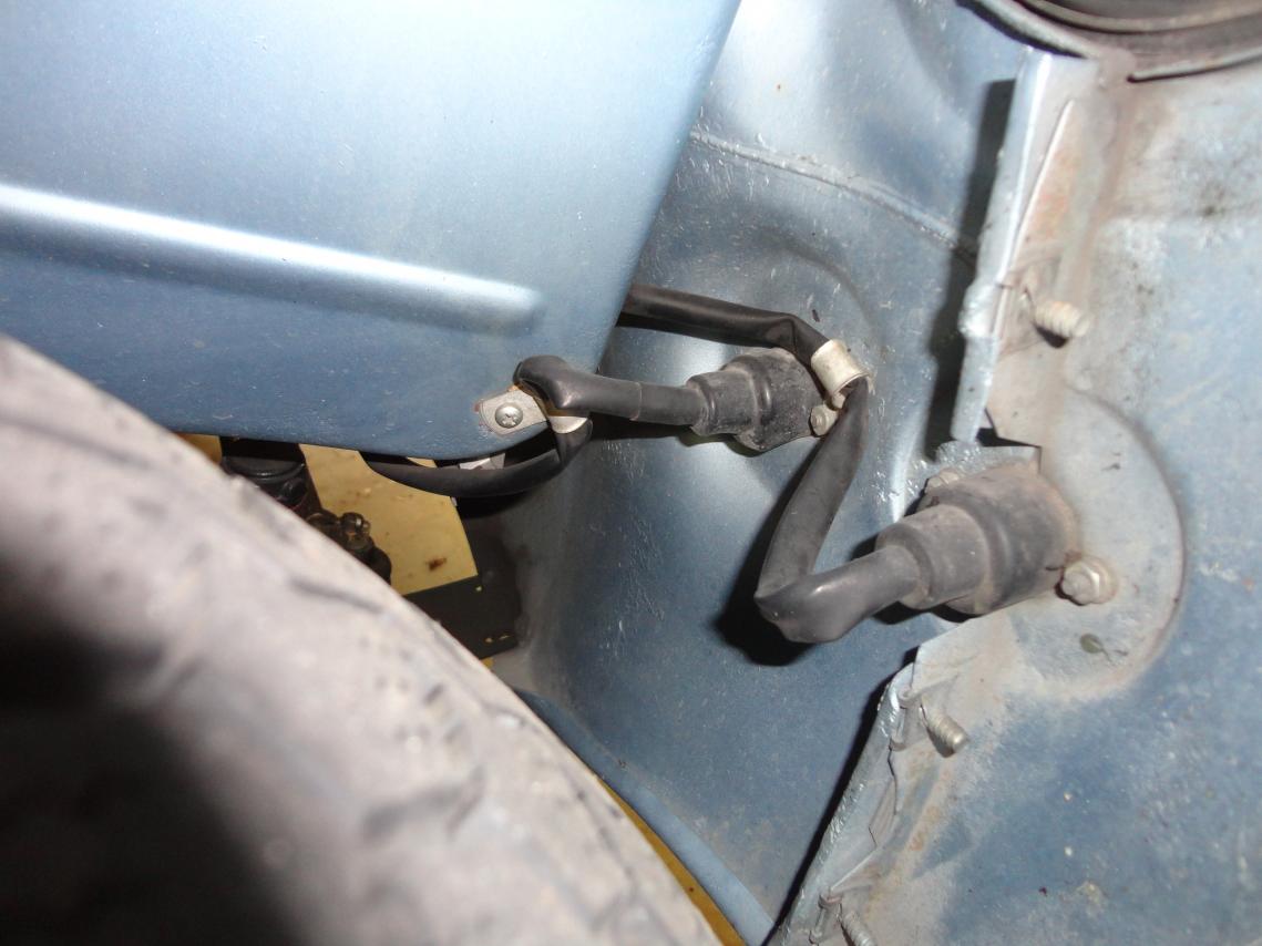

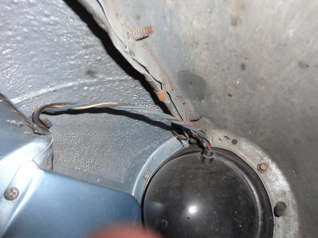

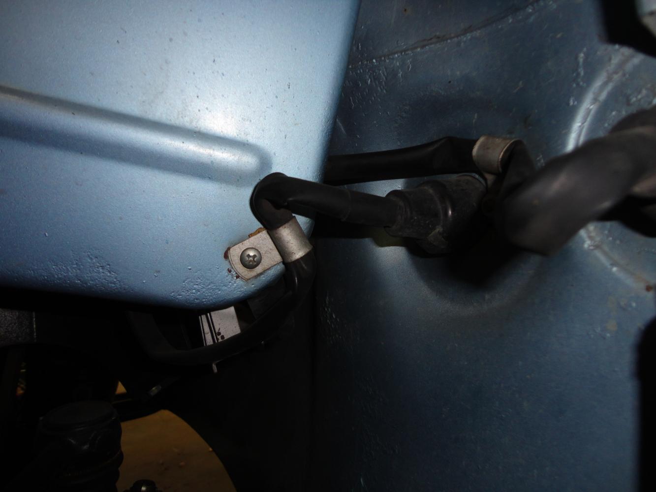

Only one I could find in the Andersson and Moment page 88
Thanks, always wondered where the hole in the splashguard was for.

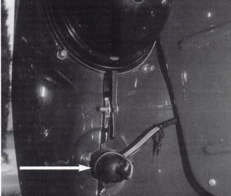

I'm still assembling, but I believe on the other side of that wheel wheel extension(splashguard), is used for that weird short twisted bracket to connect the splashguard to the lower grille/surround mounting point for stabilization.

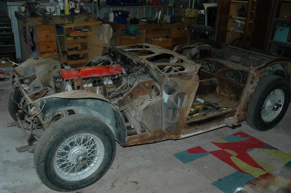

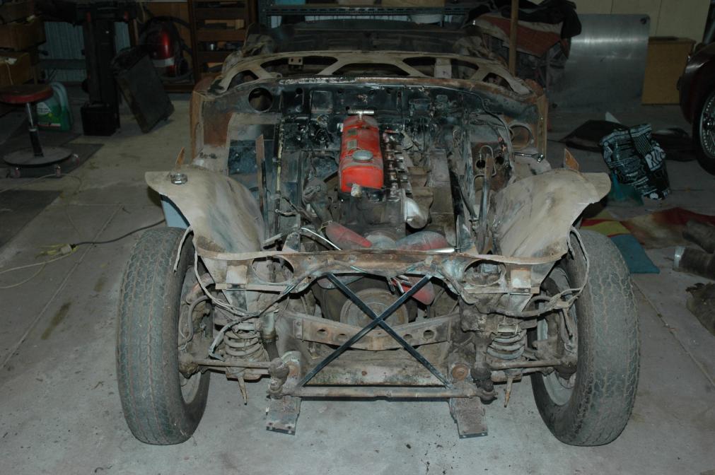

Hi Patrick
not sure if this helps but these are pics of my BN4 during strip down. The two clips (I DSC_0113.jpgDSC_0114.jpg hink) you mean can just be seen on the tops of the inner guards. Sorry I don't have a closer picture. They just slide on and the wires go through them. Hope this helps
Matthew
I think you are totally right with that. One of the things that is missing on my car.
Forgot I was thinking of buying the aluminium version at www.austinhealeywood.com. some time ago
Looks like he is not selling at this moment. Time to make my own ...

here the infamous splash brakets, hold to the splash from the angled part and from the gril from the flat part
https://picasaweb.google.com/lh/photo/DjgwtzLo2czrkoB4Ez4vZ9MTjNZETYmyPJy0liipFm0?feat=directlink

Hi Patrick
not sure if this helps but these are pics of my BN4 during strip down. The two clips (I View attachment 27915View attachment 27916 hink) you mean can just be seen on the tops of the inner guards. Sorry I don't have a closer picture. They just slide on and the wires go through them. Hope this helps
Matthew
The wires look as though they were "cut" from the harness that goes to the headlight bucket, but they do help. Thanks!

Excellent photos of the "steady brackets"! Thanks!!
