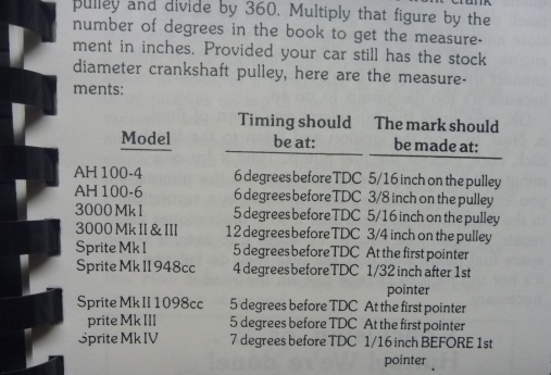

From Norm Nock's book, page 88:

one thing that is confusing me-
the timing for a stock set up should be 12 degrees BTDC ( according to the previous post, I thought the manual said 15?)
following installation of electronic ignition the timing needs re setting but to what number?

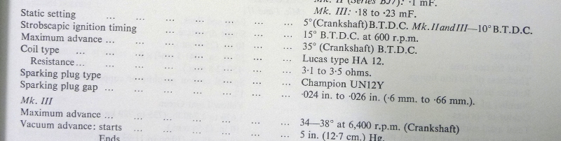

From the manual, page 21:

The 12 degrees was per Norm Nock, not the manual. That screenshot was to illustrate that the dimensions involved were referring to crankshaft degrees, not distributor degrees.
The 6400 rpm's a laff, isn't it. :wink-new:
