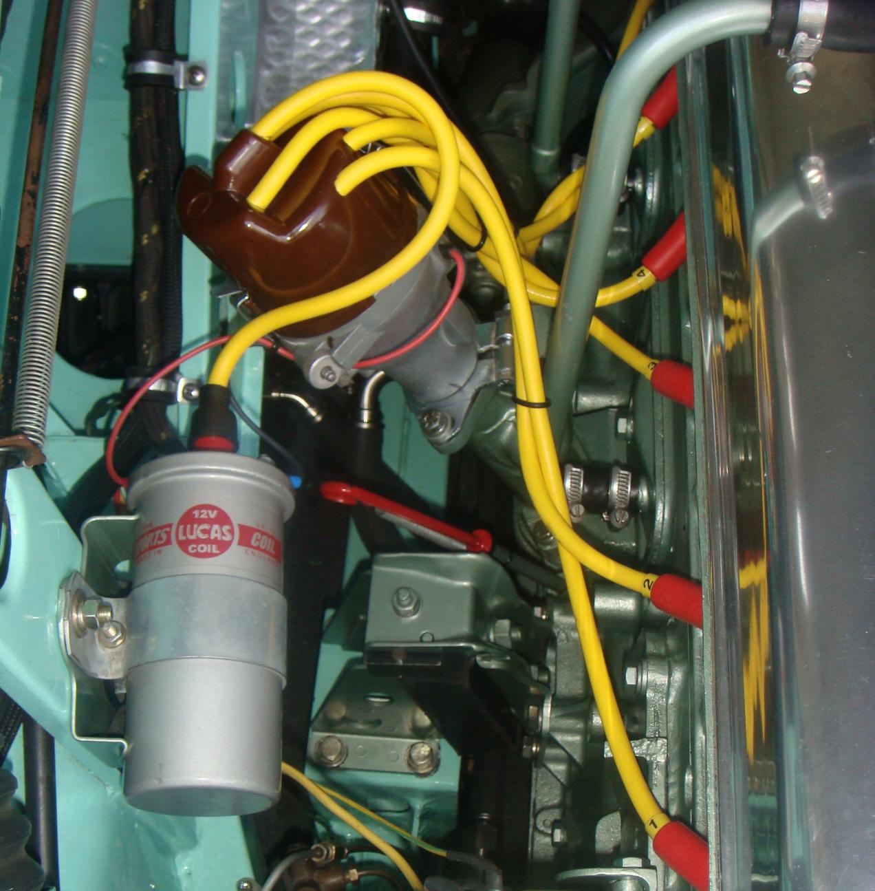

I have a fairly high performance engine in my car which I use for hill climbs and sprints during which I am regularly at maximum revs. I've detected a hesitation through the range which I'm thinking might be due to ignition issues. I've resisted electronic ignition for 'originality' reasons but I think I should really convert in order to get the best out of my engine,
At present I don't want to go for the 123 or the Luminition, the latter because of the external pieces.
Petronix seems to be well thought of. (In the UK it's marketed as Aldon)
I have some questions and comments that I'd like some feedback on.
- I understand the original Petronix suffers from potential burn out if the ignition is inadvertently left on. Is this correct?
- the Petronix II cures that problem and has a variable dwell module that maximises the spark throughout the higher rev range.
- Aldon are telling me that I need their low resistance coil to work with the Ignitor II as that is what the dwell module requires. Is that true or are they just trying to get me to buy their full system? The coil and Ignitor II together are quite expensive over here. I have a perfectly good Lucas DB 105 Sport coil presently installed.
- They also tell me if the system fails then points could not be re-installed using their coil. (I suppose I could carry the 3 ohm coil as a spare for points only usage)
I guess the Ignitor II is the better option.
Any thoughts and comments welcomed. Anything I am missing?
