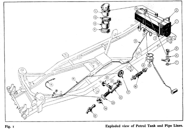

it turned out to be a small rubber pipe connecting 2 metal pipe towards the rear on the chassis just in front of the rear wheels its a metal compression fitting No 17 here.
this video shows the issues and blow through. you can hear it clear
also check your tank breather is working either the tank pipe (no8) or the hole in the fuel cap
DavidApp
Did you mean connector 16 was causing the issue or was it a piece of rubber tube in place of the connector? Item 17 is the rubber grommet that stops the pipe rubbing as it passes through the frame.
David
yes thanks for spotting that. the connector is sometimes just a bit of old rubber pipe that degrades- had me frustrated for a couple of weeks and competitions.
